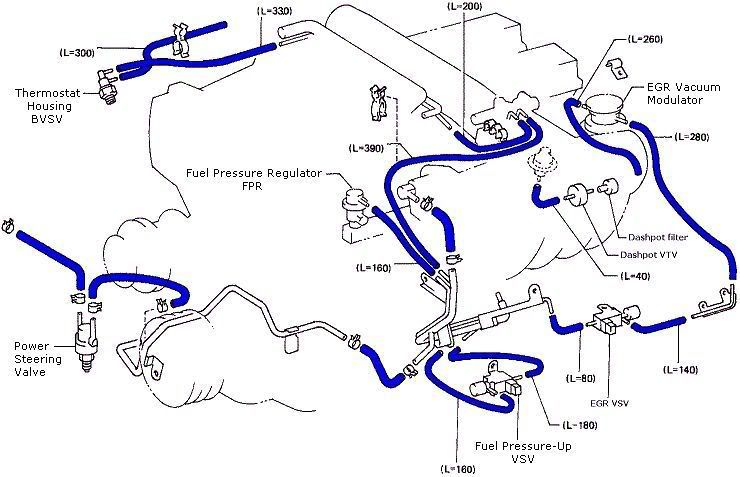

It is a nice starting point. theres a little rust Im going to have to take care of, but it is really minor. Id really like ot get these lines sorted, if it were an MR2 I could do it blindfolded. Do you remember anything about the vacuum lines when you did the swap? I have some pics of the spots I have some questions on. If youre willing to give me some info I can email you the pictures.

Ive got a Trust gasket and ARP studs on the way, but I wanted to make sure I ahve all the lines run properly before tearing into the engine. IT runs fine for about 20 minutes and then overheats and starts running rough. If I know anything I know that when theres a BHG, there usually other stuff wrong too, so if anyone has some wise words for an MR2 guy moving into a basketcase Supra Id definitely appreciate them. Anyone have a BGB?

Ive only had a few minutes to look under the car and I couldnt find anything to hold the hood up, but I had enough time to snap some pics. I didnt see EGR anywhere, but then again, Im unfamiliar with the 7M.
I know the return line from the charcoal canister is open to atmosphere as well as a ew other lines I took pics of.

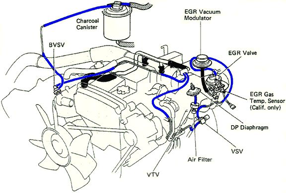

Also, maybe I can be of some assistance with the vacuum problem, here are some vacuum hose diagrams.
Some of it maybe missing on yours though as the JDM engines did not come with the EGR equipment that the USDM motors came with. So you will have to look and see what is left. If you have any questions feel free to ask, And once again welcome to the forums.

Excelelnt, that diagram has helped quite a bit.
