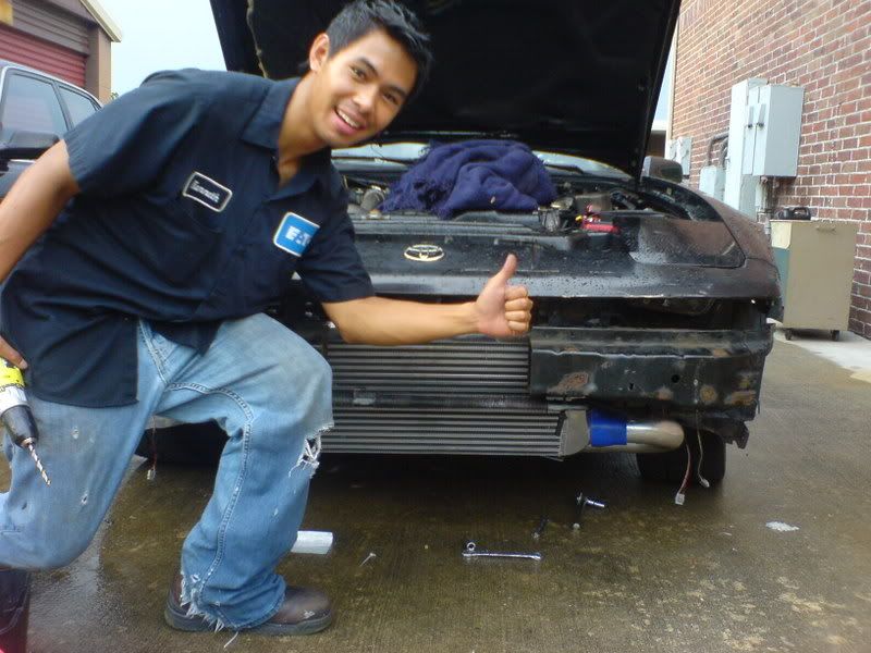

I got my IC mounted a while back and forgot to update this thread.
It's the only pic I have for the time being. That's my buddy Ken who fabbed up the brackets, mounted the IC, and routed the IC pipes. It's mounted at the same angle as the stock IC and the stock MA70 overflow tank fits, but barely. I did to my tow hooks what IJ did with his: binned'em cuz they were in the way. Hopefully the car may not need a tow for a while. lol
And yes, I do realize what's wrong with my crash bar. :nono: There was a bit of a miss communication between another friend that cut the bar and myself. So I'm either going to have some plates welded to the bar or just find a new bar all together and have the "Turbo A duct" hole cut in properly.
