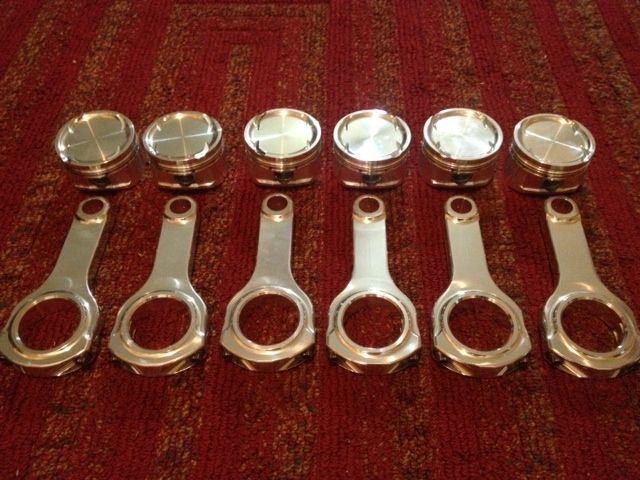

Nice piece from Vibrant. This Vanjen clamp will eliminate blowing off couplers and make for very easy R&R. No more silicon hose and t-bolts.
ATF's billet SFI GM adatper
Modified lower radiator neck and oil return to get around the complex exhaust manifold
Modified upper radiator neck to clear the huge GT55 style compressor housing
