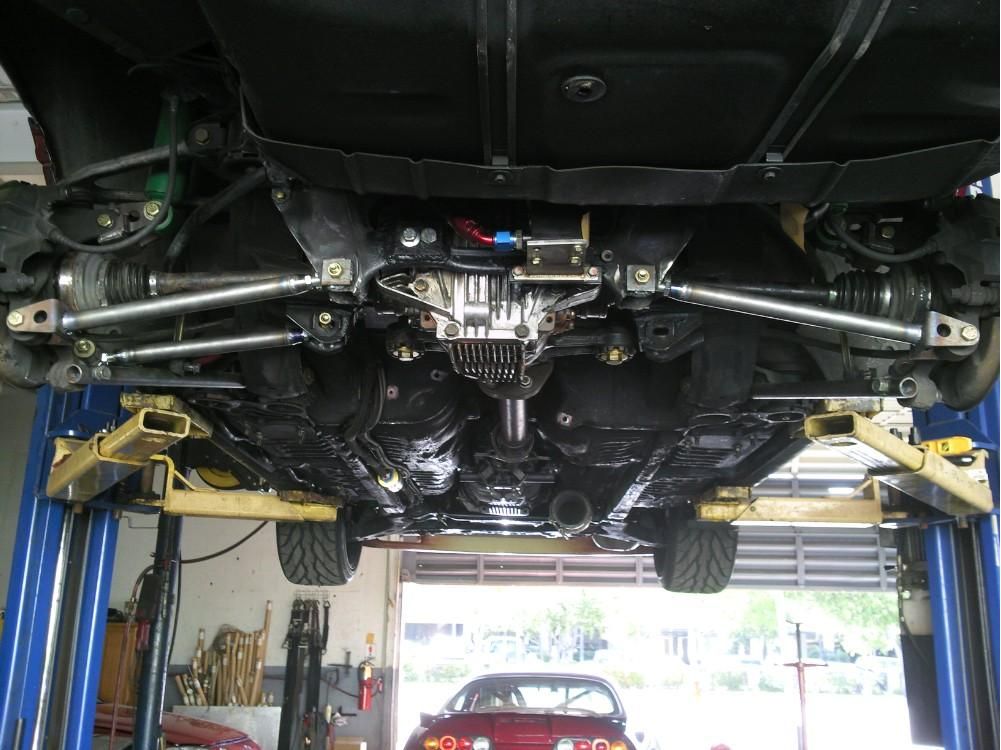

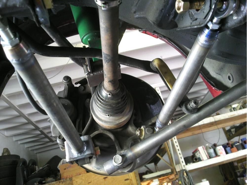

Any chance you guys would mind posting up some pics of your diff/subframe set-up. You had mentioned on SF about the track arms, would be nice to see a picture of how you guys have it set-up?
Im assuming its something similar to Seans from Titan, minus the mk4 diff:

The rear end of our car is much simpler. Like I said we built custom track arms but the rest is stock as far as control arms go we haven't moved the strut inboard .and all the mounting remains in the stock locations. I don't have any pics right now.
Thanks Jason

Would love to see pics
