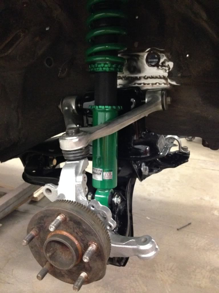

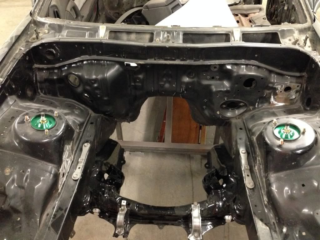

Got the front and rear subframes back from the powder coater.
New Ronie K subframe bushings
Front lower control arms
More parts back from the powder coater.

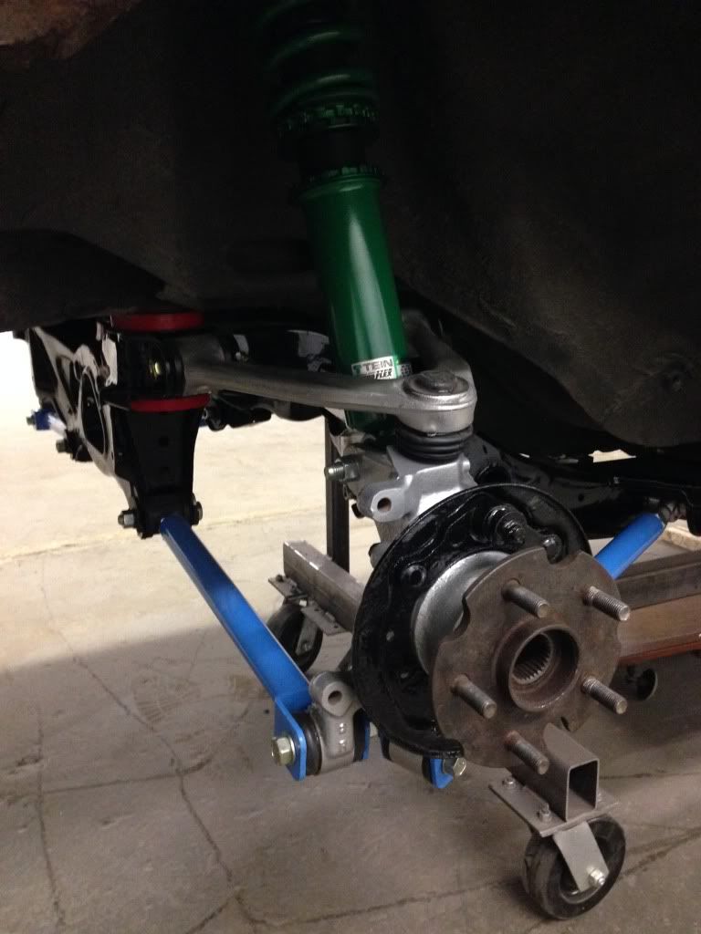

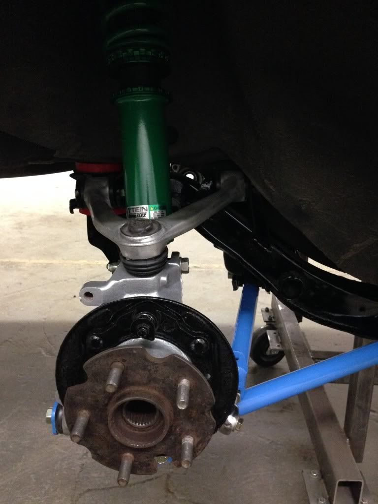

Brand new bits and bolts
New control, camber, traction arms

How did you just mask the knuckles when you got them powdercoated? so you dont mess up the hub surfaces?
TMMCSupra
Oct 2, 2010
90
Waterloo, Ontario
DeMoN2318;1974937 said:
subscribed
The shop that did the media blasting and powdercoating used high heat masking. They masked everything inluding any bolt holes.

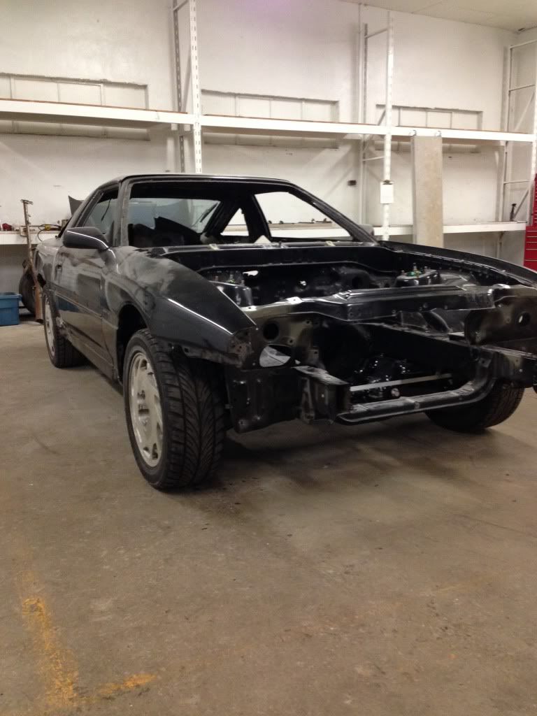

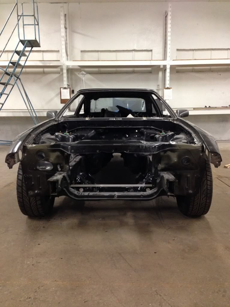

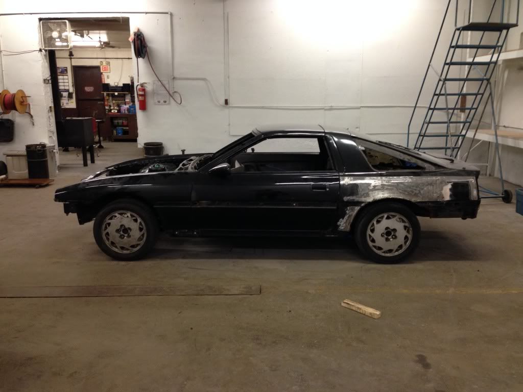

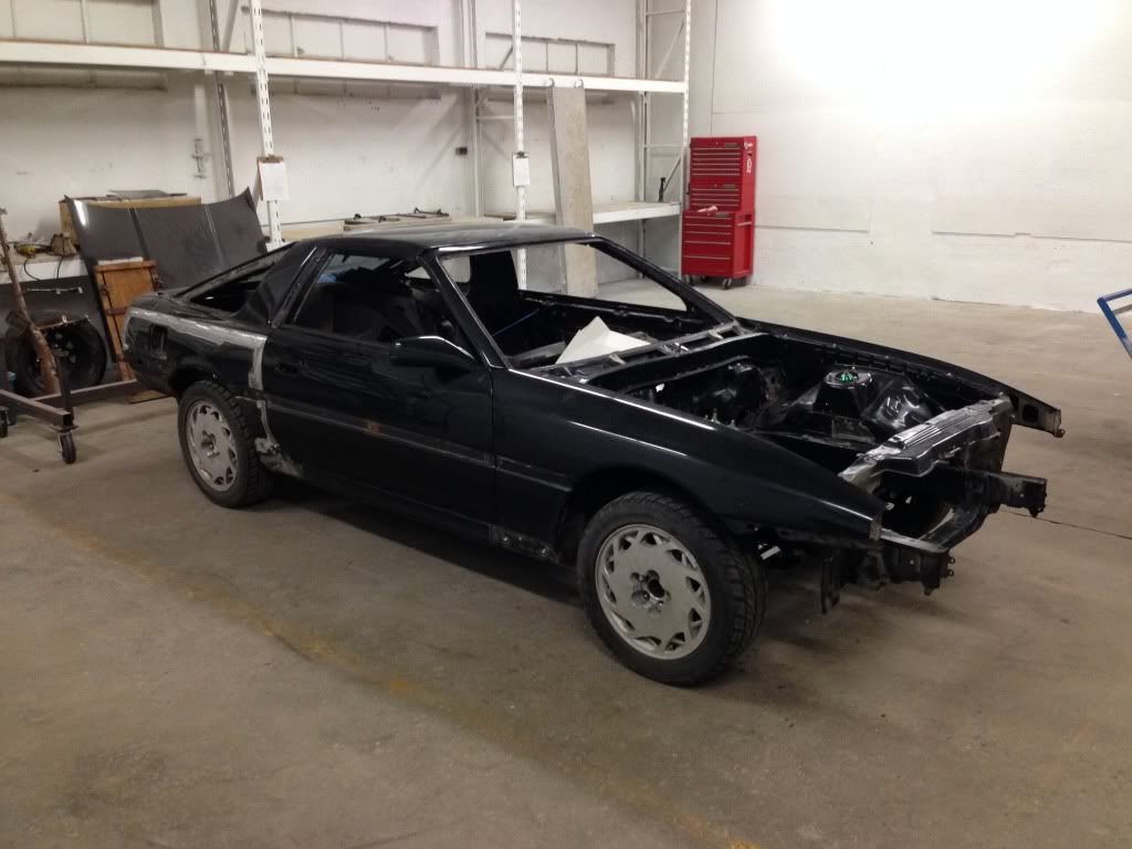

A few more pictures. The cars back in wheels for now so I can move it.
hvyman
Dang Dude! No Way Man.
Apr 17, 2007
12,568
Fullerton,CA
Did you strip the old under coating off? What are you going to use for a new coating?
Looks good.
