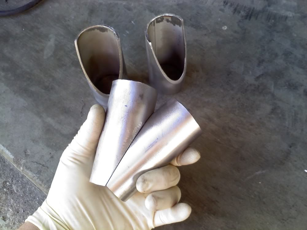

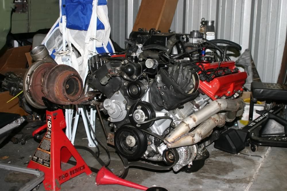

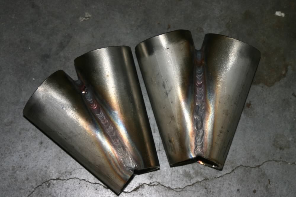

Okay dropped off some stuff at the shop. Snapped a pic of the collector, ready to be tigged.

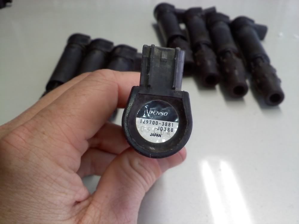

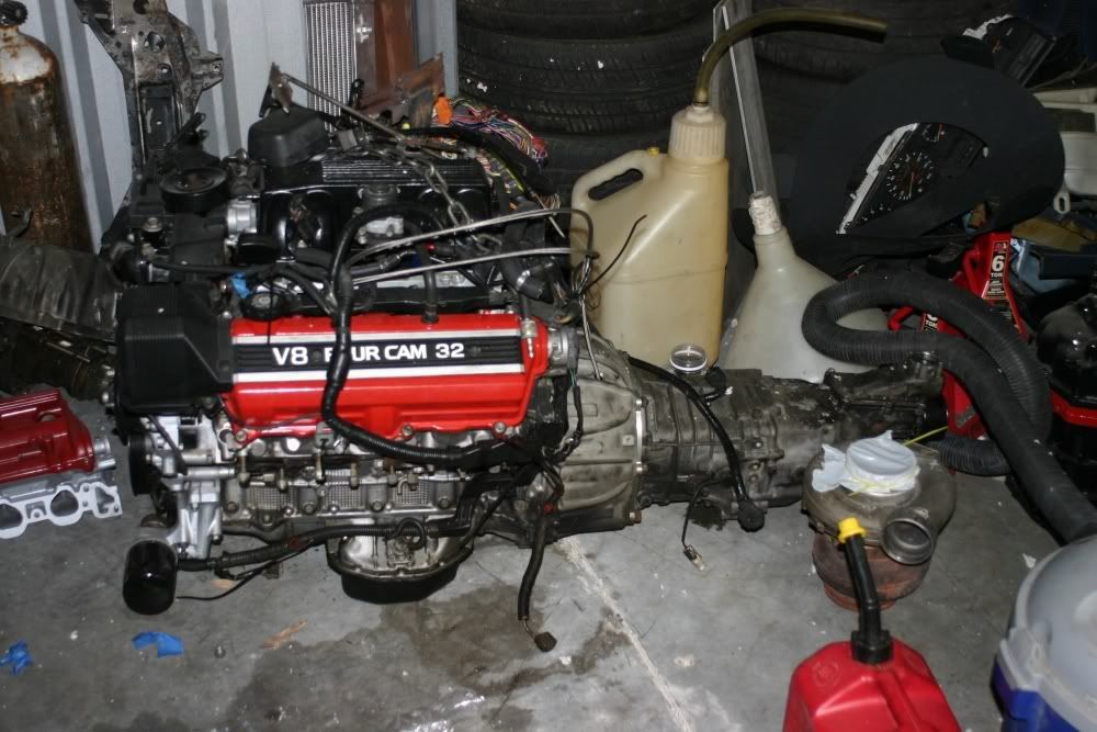

And I will try to use these CBR 600 F4i coils on the MS3x.

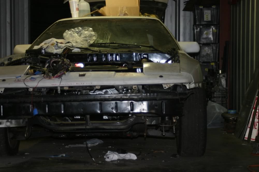

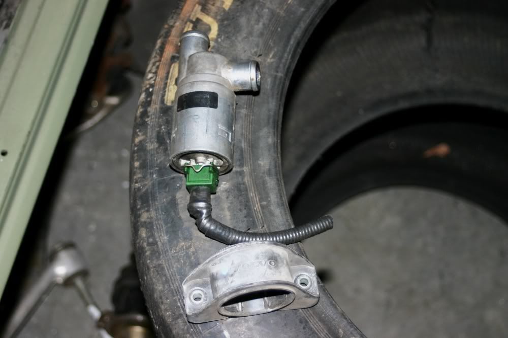

Picked up a Volvo 2 wire fast idle valve, should work well and very simple.

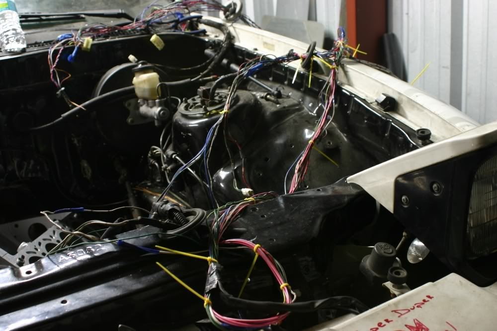

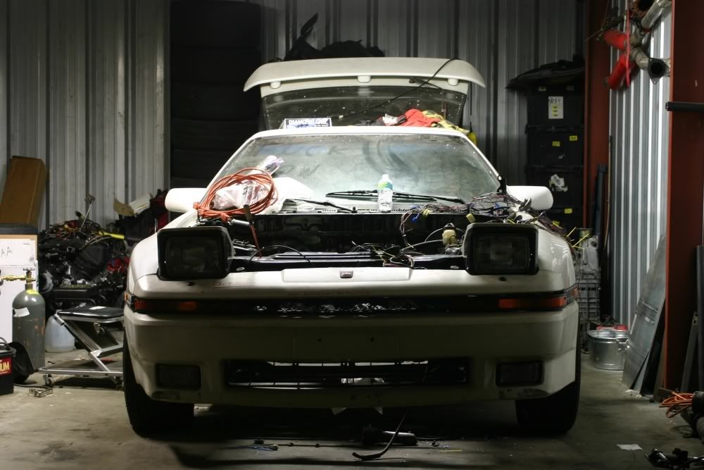

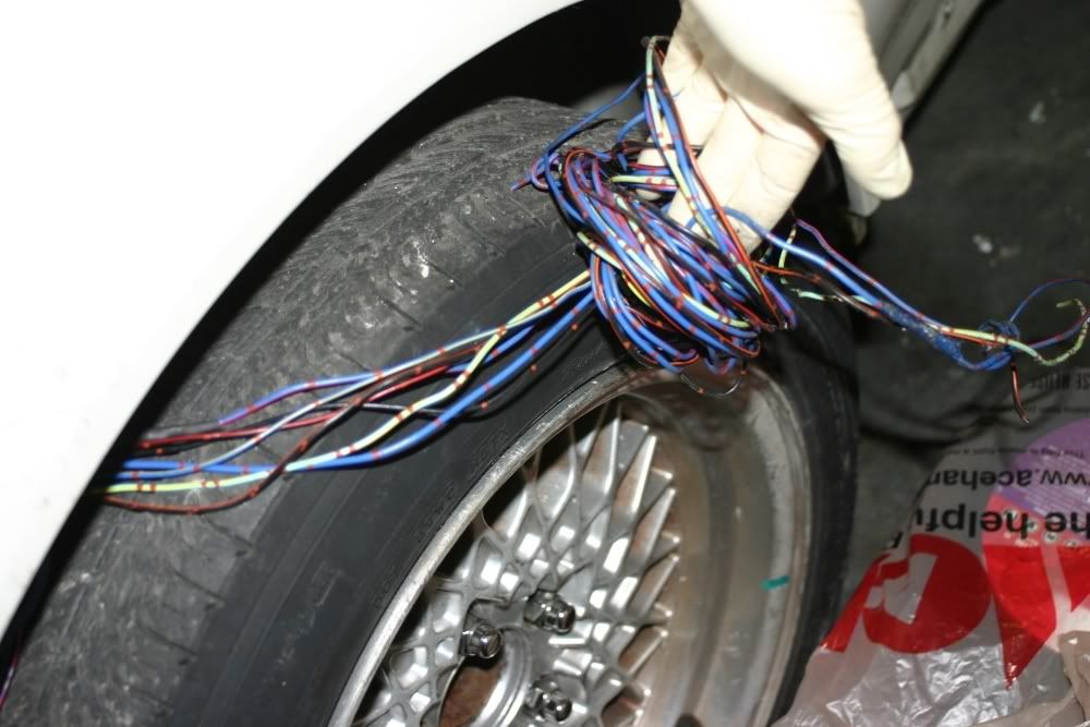

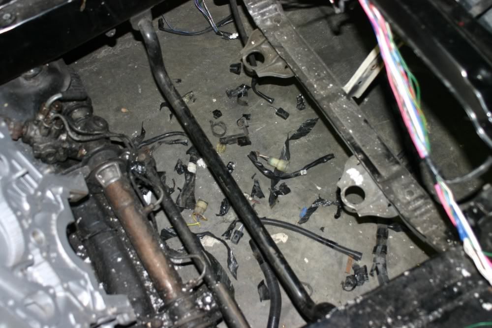

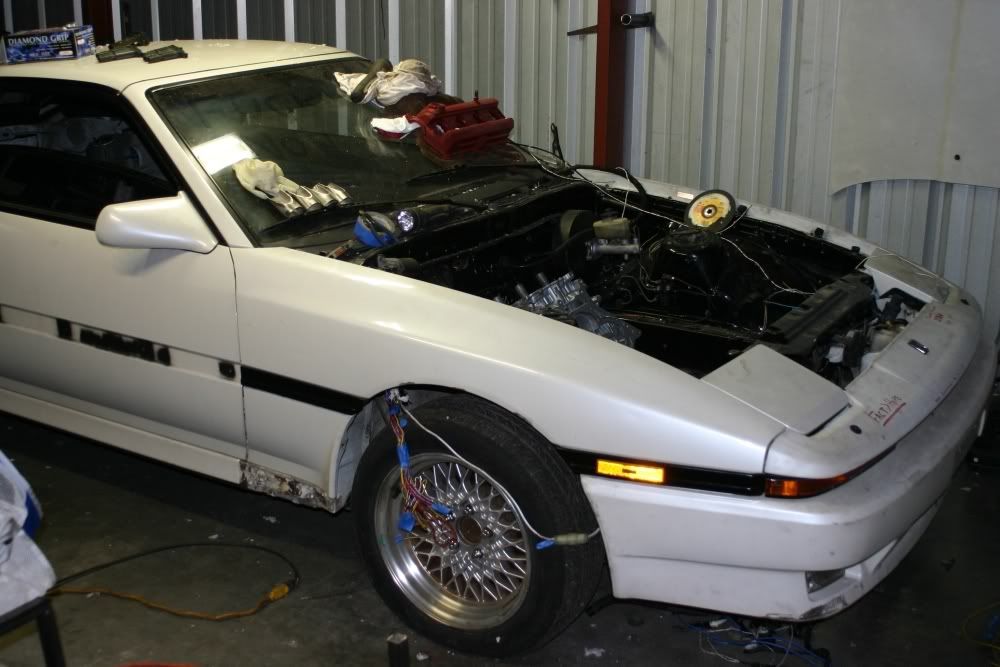

I cleaned up the engine bay wiring a lot today... pulled more and more out...
This stuff still needs to be pulled through and cut off
Car has seen better days..
Pulled awhile ago but yeah

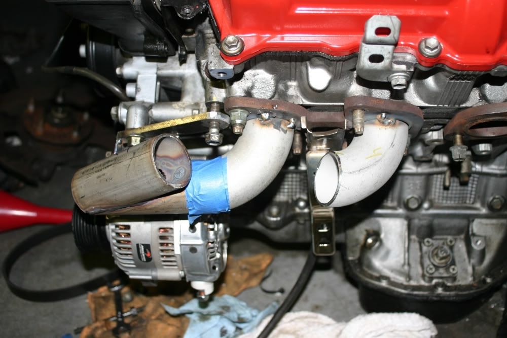

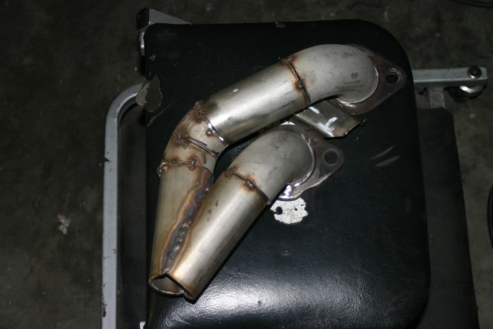

Some collector action

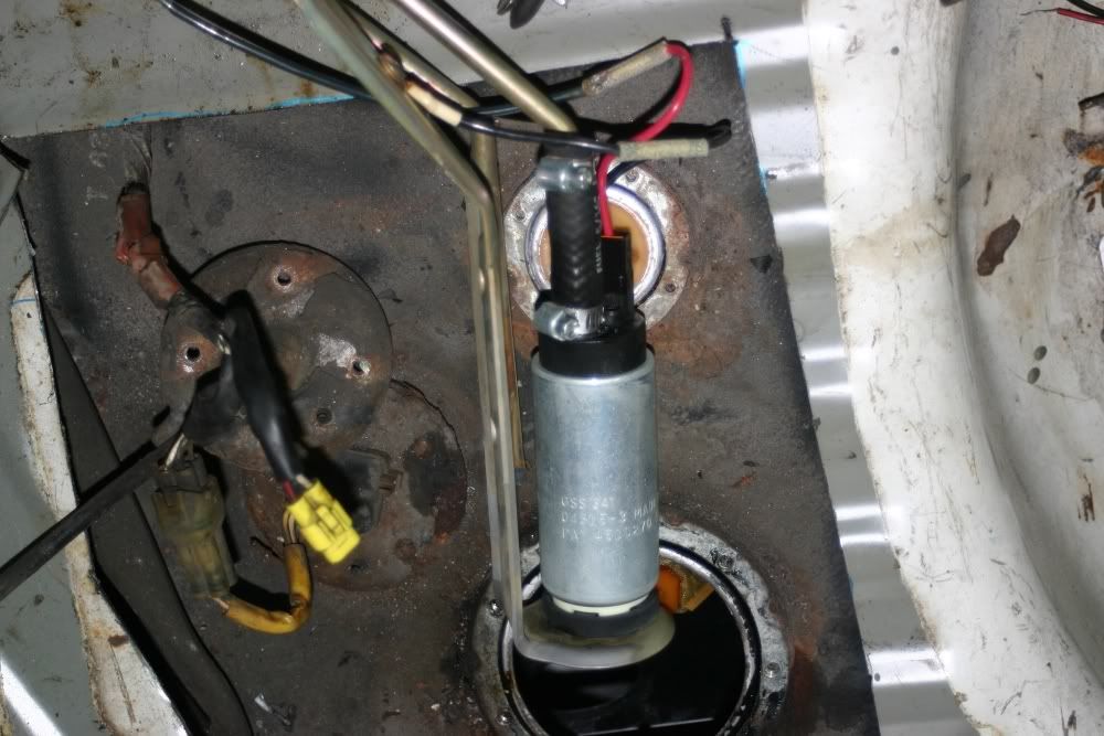

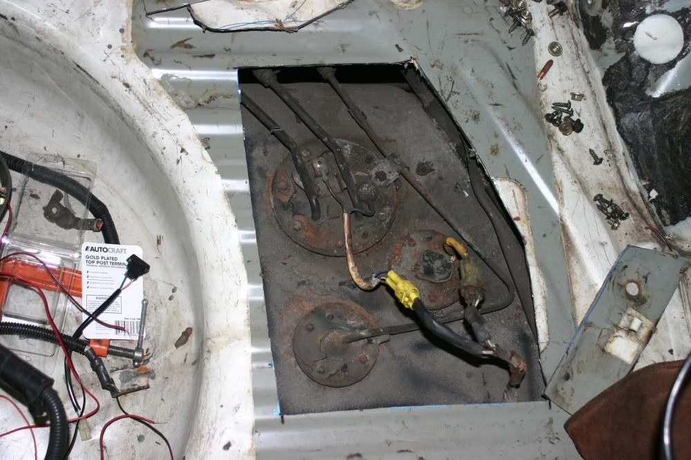

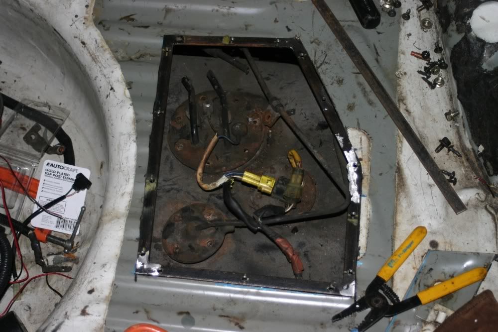

Fuel Pump Access cover in the werkz

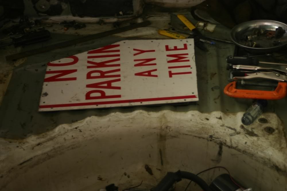

Street sign could be used to cover the hole :)
Came with a free Walbro, didnt even know!

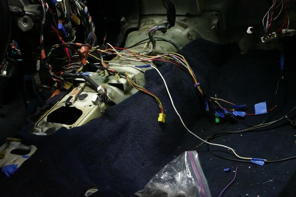

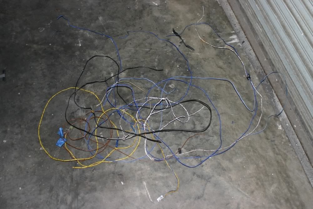

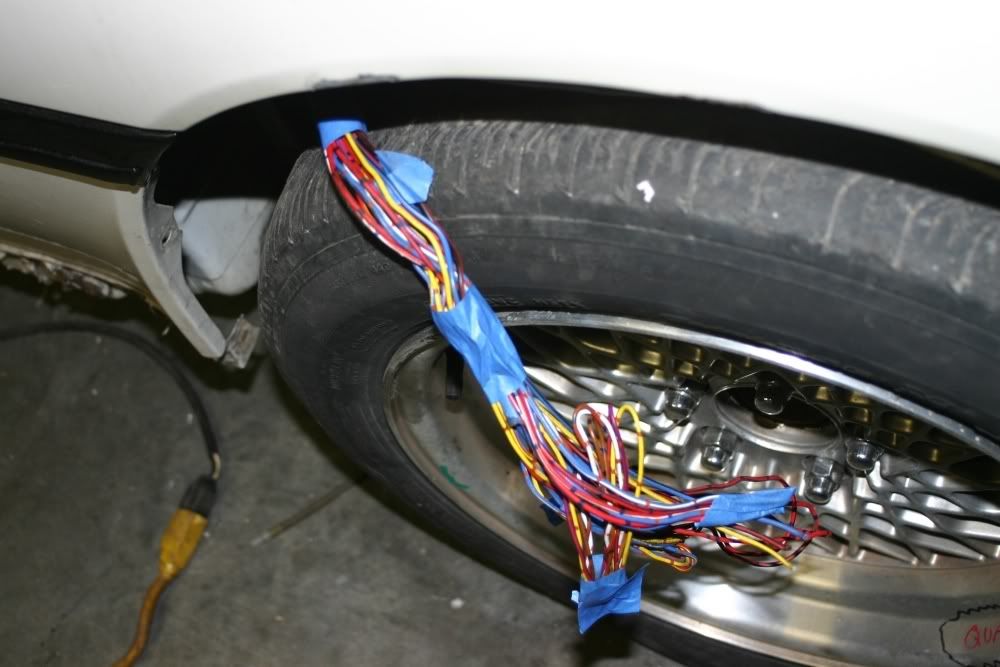

Remember that good old body harness for the enginebay into the fuse box and into the cabin... its been reduced to the following...

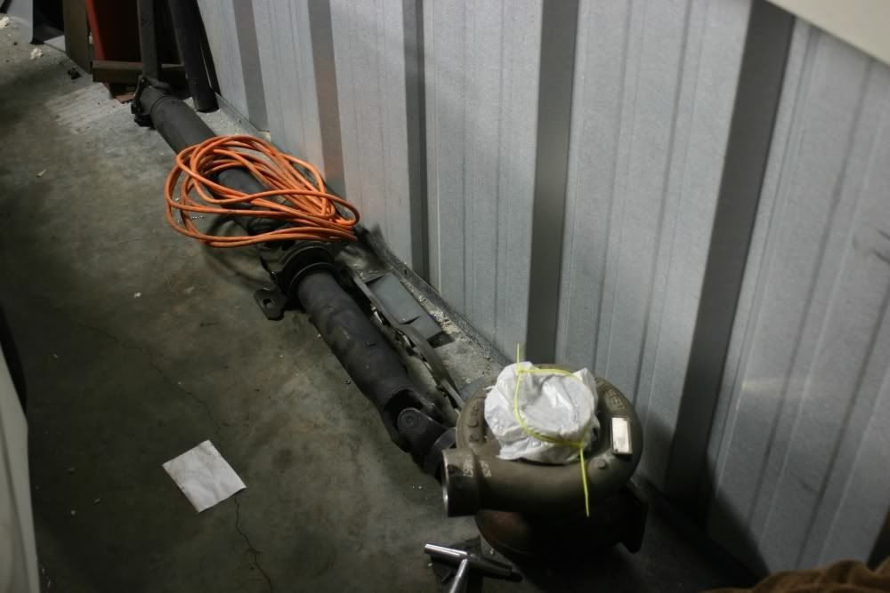

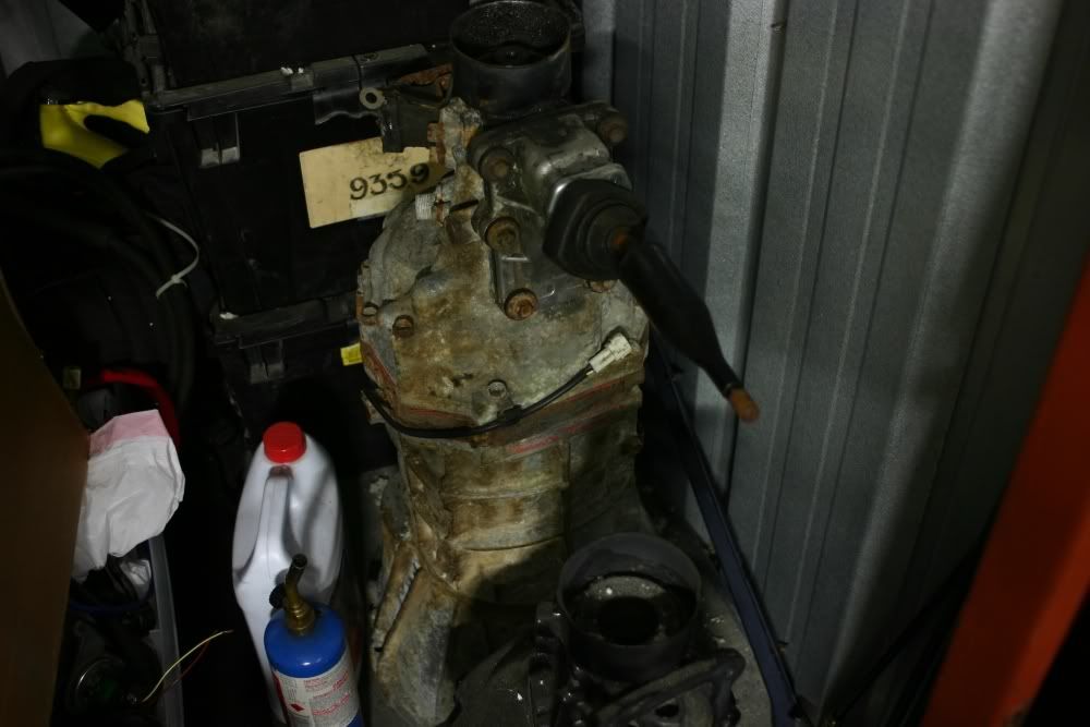

$100 R154... and $20 driveshaft... SCORE!

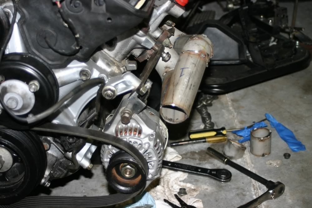

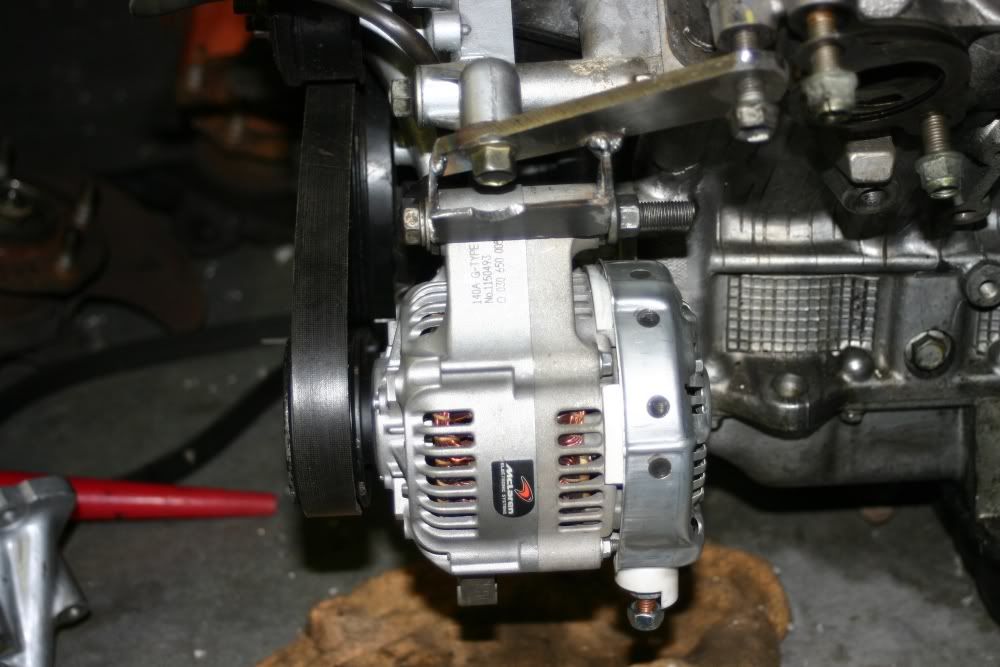

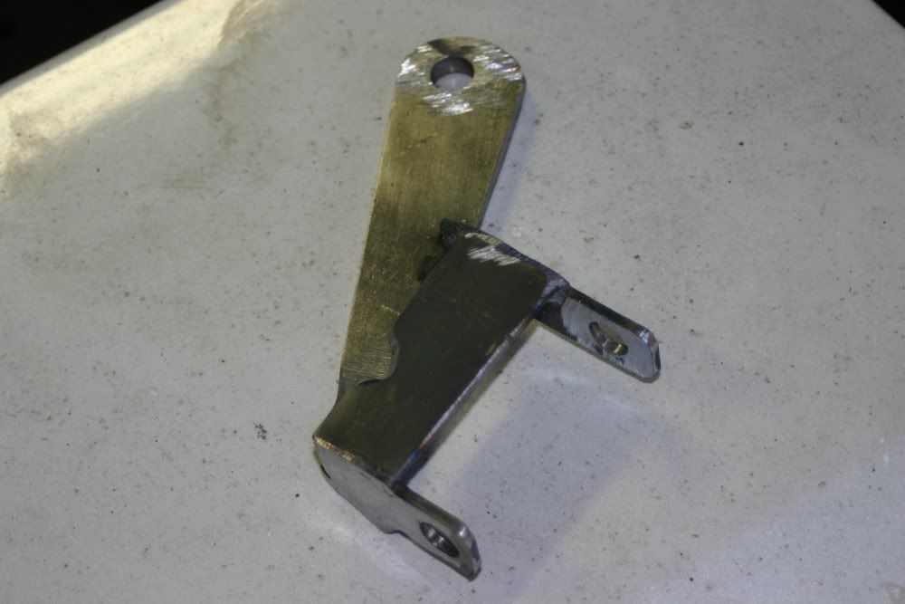

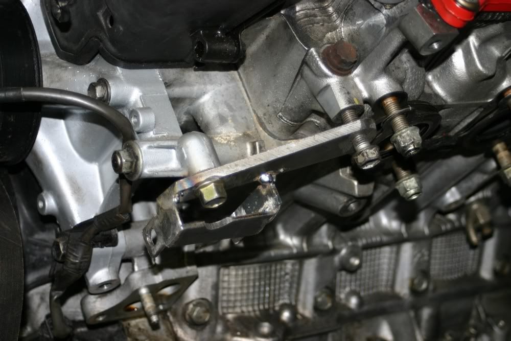

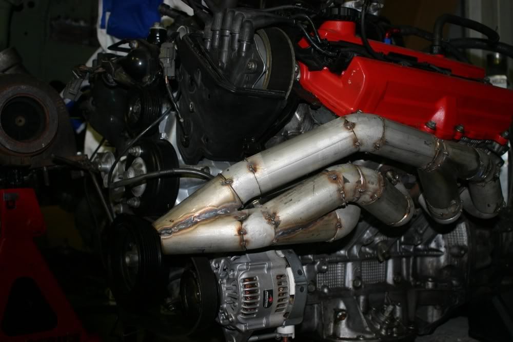

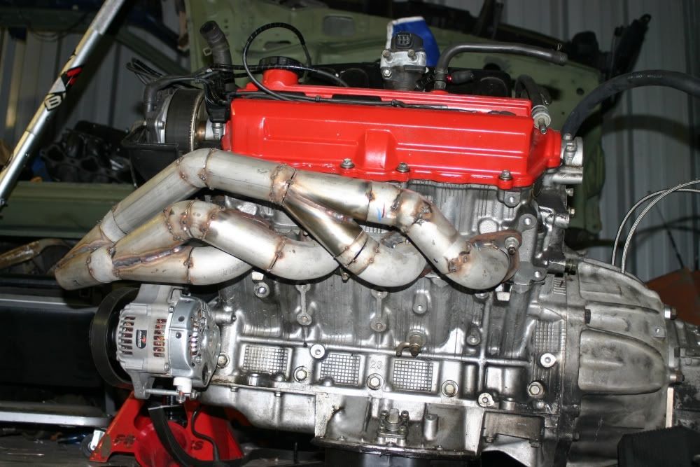

I borrowed my friend's Mclaren alternator to mock up... ordering one of my own soon. Its a 1 wire, 140amp, small alternator... It is the tits.
Bracket in the works..
Seems like it fits...

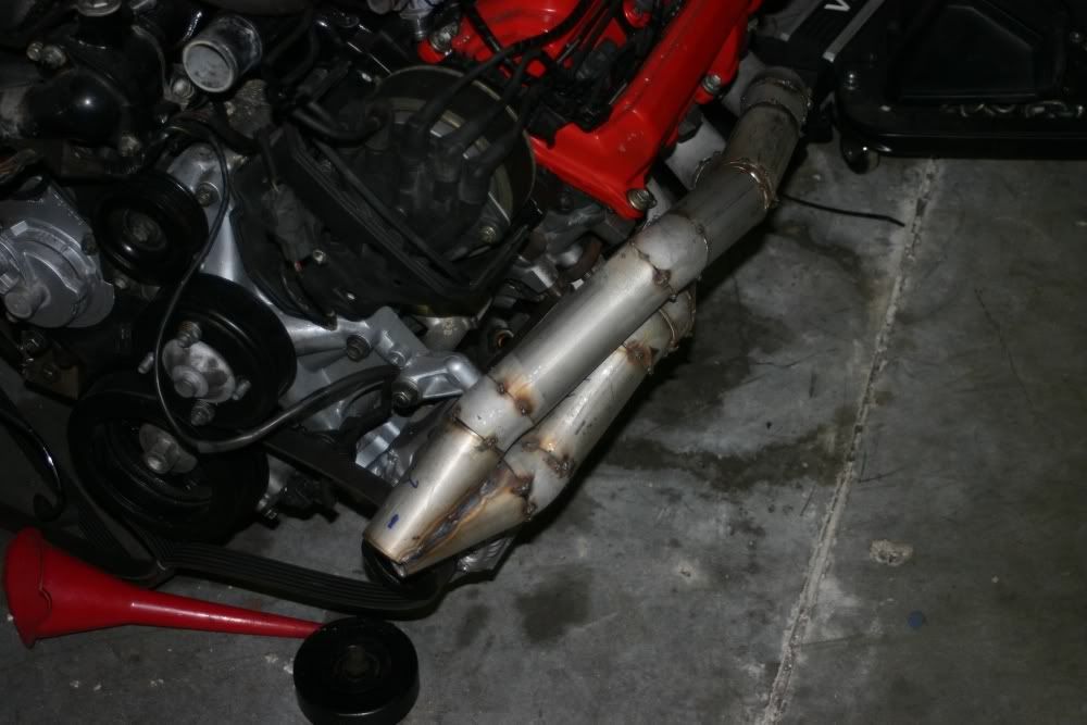

Waiting on my flanges to come in still... but I am using stockers to mock up at least... Mig SS wire is not at all pretty.... luckily its getting tigged for the final steps.
It just grazes the frame rail.... little notching and we are good to go... Its a tight fit to anything turbo related here.
Also cut down the stock oil filter piece... going to run lines and relocate it so it will clear the alternator.

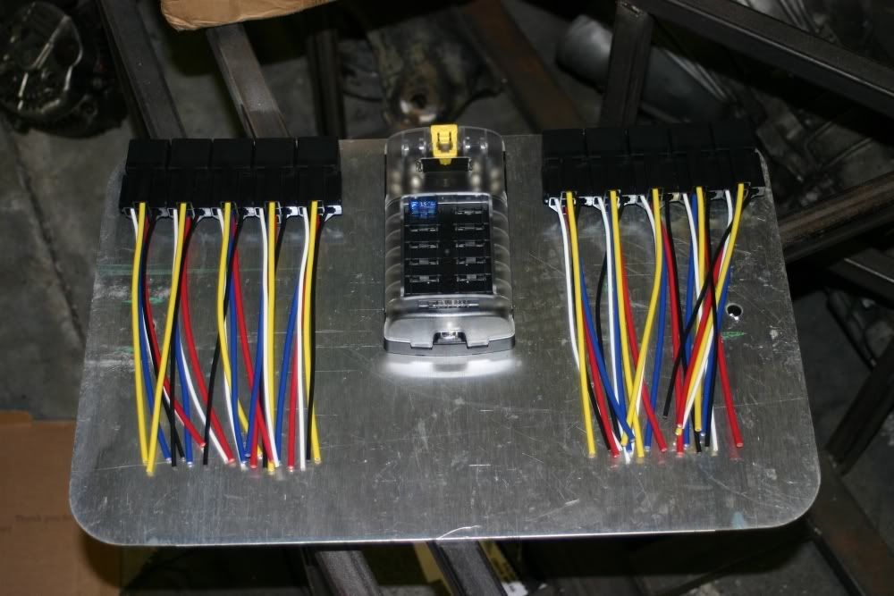

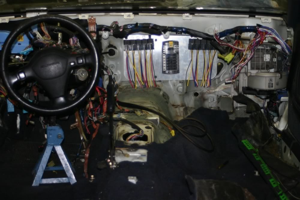

Made a fuse panel out of an old street sign lol... love these sheets of aluminum. Includes a BlueSea fuse panel, 10 relays and will have 2 circuit breakers.

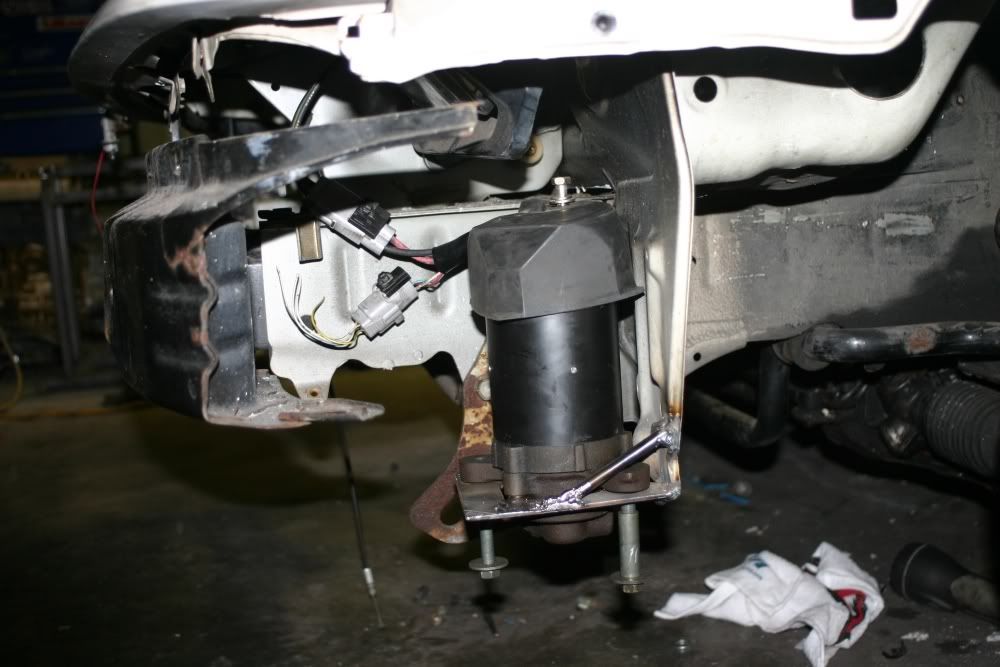

MR2 Powersteering pump mounted in front of the wheel behind the bumper...

And worked on the driver side turbo manifold... enjoy :)
