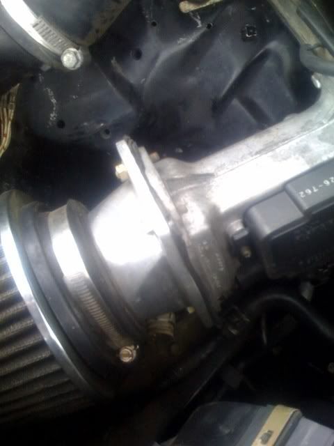

Right there, what kind of MAF adapter you got on there? Take a pic and show me.
It a cheap filter and bracket that came with the car. I am gona change it soon. The problem is I blew my whole wad on everything else. I can get you the pic. but can you tell me why this would cause my problem. Before the burnt valve , and the head work the car ran fine.

The MAF adapter, if it doesnt sit square on the honey comb will throw off air readings and cause your jerking under boost. Also if the intake air has a bend right before the MAF it will do the same thing. The mafs need to have the honey combs wide open and the air has to hit it dead on. It was a pain in the ass fixing this issue when we were making the bolt on CAI, had to get just the right MAF adapter

here you go, tell me why you think this could my problem

Take the filter off and take a pic of the honeycomb on the inside for me. It does look alright but it could be covering up part of the honeycomb

i dont think it is. when i had everything disassembiled i took a lot of time inspecting everything and cleaning things that could be cleaned ( no i didnt try to clean the AFM sensor, I did spray the honeycomb with electra clean with the sensor removed ). I would have noticed if abything was covering up the honeycomb.
i still cant help but thinking that it has to be something that I did because it wasnt doing it before.

he's talking about when the AFM Adapter is mounted to the AFM, if it's covering up part of the honeycomb (most likely the corners of it)
