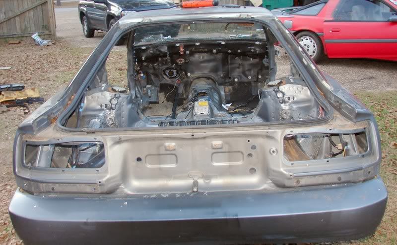

Now, for motivation............I swapped every single piece of interior in my car from the firewall to the tail light covers in about 8 hours. Of that time, I had to pick between 3 different dashes, and then figure out which of the 3 dash wiring harnesses was going to best match my engine harness. Now for the kicker, I also had to pull all those parts from my other car! Interior is not hard. Just take your time, and don't force anything. If you need any knowledge help while doing it, shoot me a PM.
Here's what I mean by every part:
MarkIII4Me
Project OVERKILL!!!
Apr 10, 2005
1,250
Charleston, SC
Damn! You pulled the floor boards and everything. My car isn't that rusty, but I'm going to basically have to pull the interior just the same. Once the inside is bare, I have to spray Second Skin sound deadener all over and then paint over it (just like I did with the engine bay and undercarriage). I also have to repaint many blue and ox-blood interior parts black as well as run wires and modify panels for the stereo. I'm actually looking forward to this though since I'm a aesthetics freak by nature :naughty:
