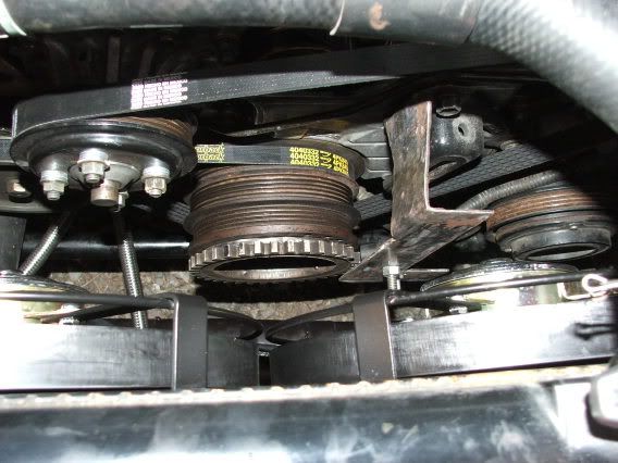

Anyone have one of those 7M trigger wheel that WilliamB82 had a few years back.
Thanks
