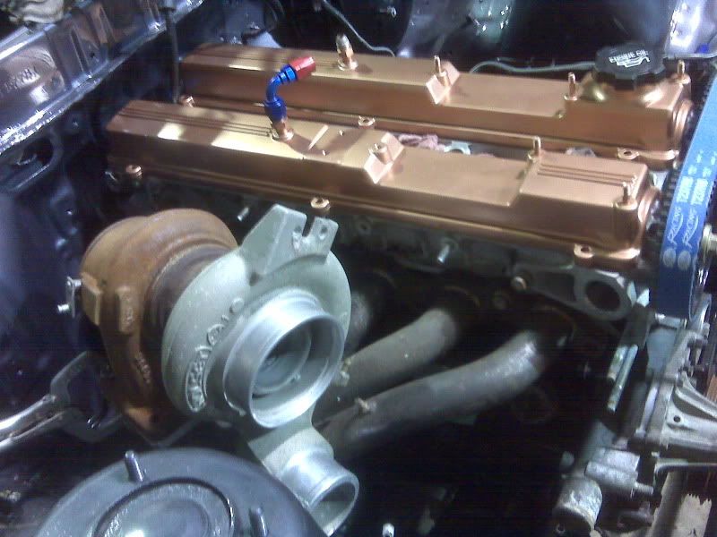

Supraboostin;1460239 said:
is that a custom exhaust manifold?
Its an old Greddy / Trust manifold. Very rare so Im told.

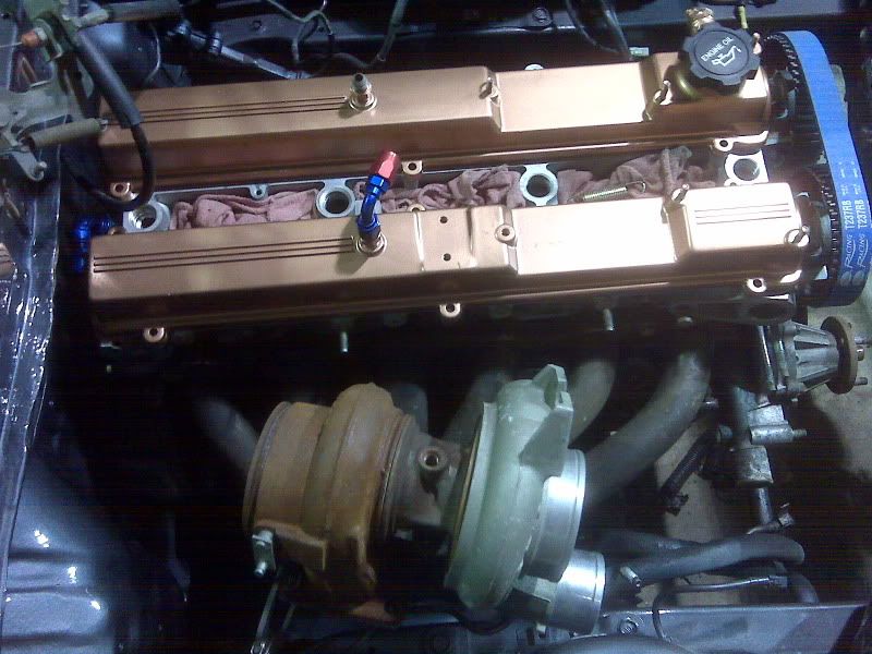

Well the 7m has:
-New toyota valves, custom face cut to remove the "7m"
-3 angle valve job
-SBC valve springs
-New valve guide seals
-Gates racing belt
-New oil pan
-Shimmed oil pump
-New front and rear main seals
-Custom valve covers

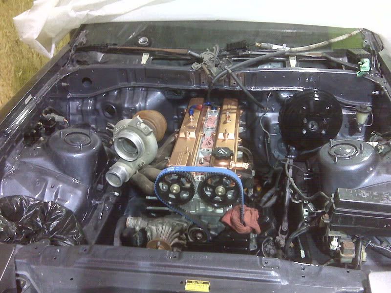

I figured you would have done this but I guess I'll have to be the one to blow the dust off this thread. Car is finally home, cleaned out and awaiting cage! It'll be at the Indy 2K12 meet!

Update! All wiring from under hood and under the dash is completely gone.
The stock brake amd clutch cylinders are gone too.
Ordering a megasquirt ecu here soon and some wilwood cylinders.
Pics soon.
