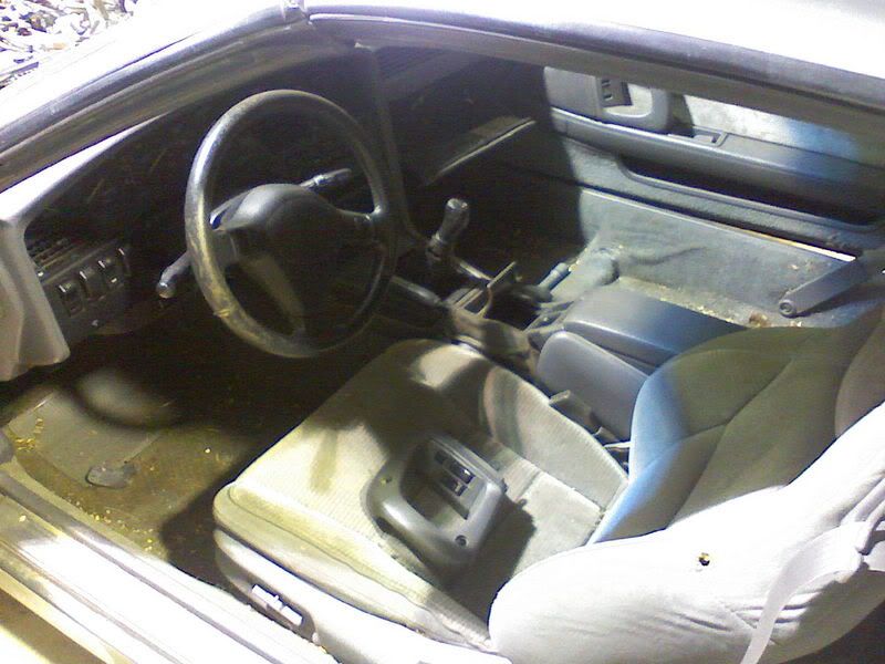

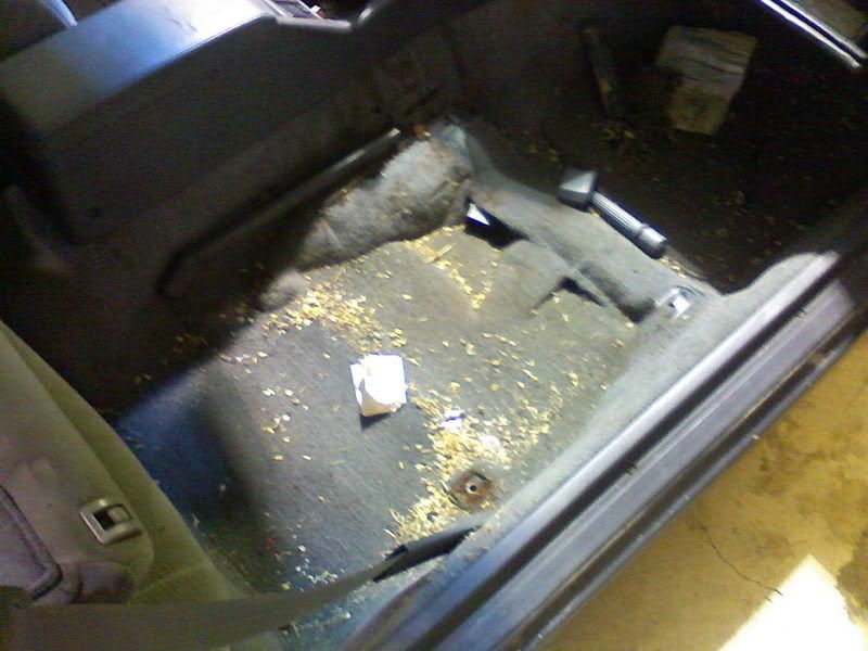

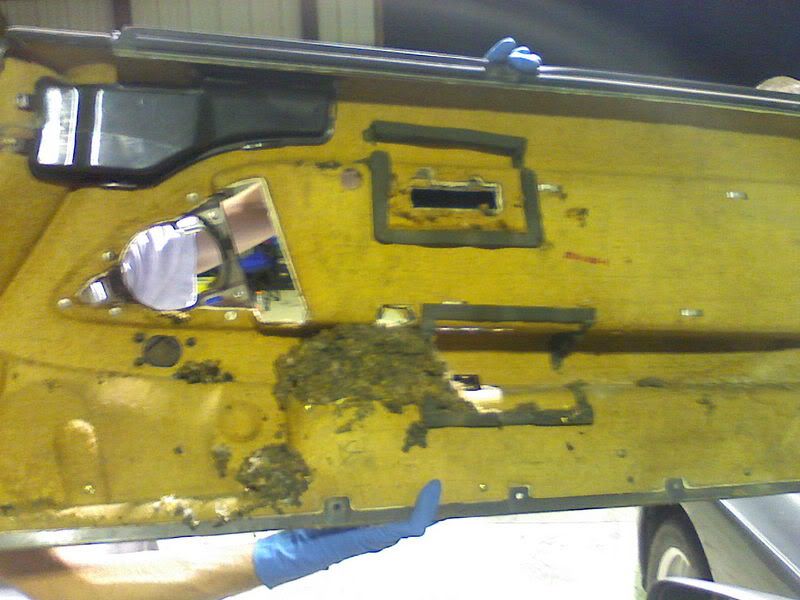

Mouse house under the pass seat...
The mouse house. I wish it smelled as good as my picture does.

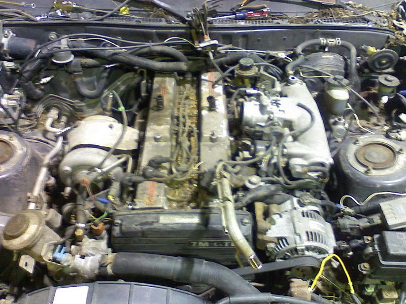

The mouse "under the hood" house....

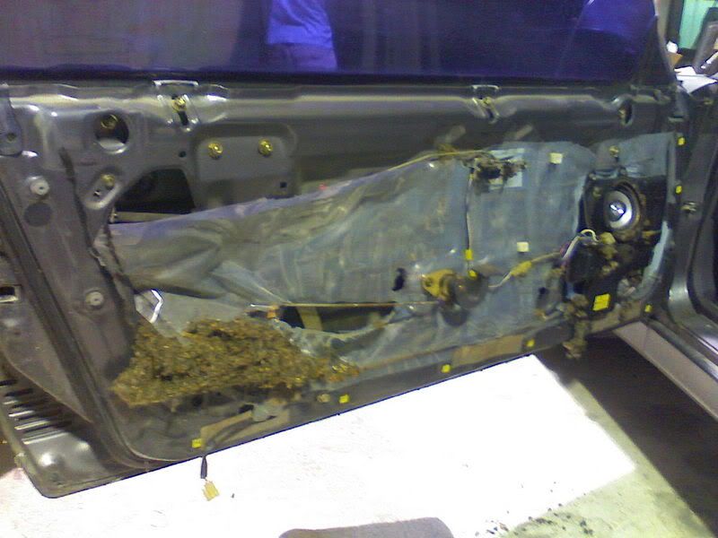

Mouse house in the door....
Mouse house in the door #2....

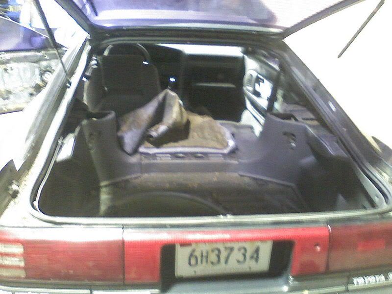

Interior starting to come out....
YOURE HIRED!
