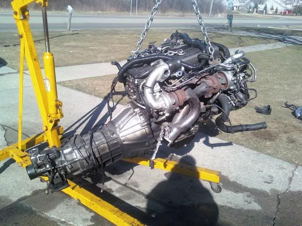

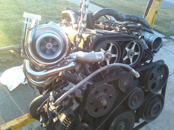

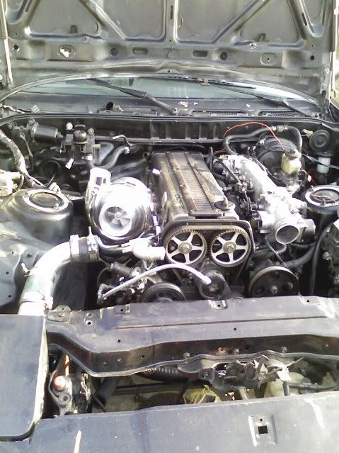

Did some progress today.
Taking the twins off, what a pain in the ass that was :(

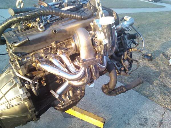

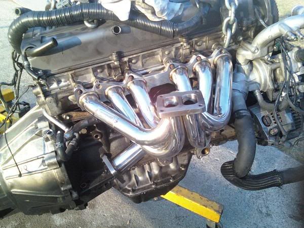

Test fitting the new manifilold
Testing the cute T76 on there :eek:)
More progress tomorrow :)

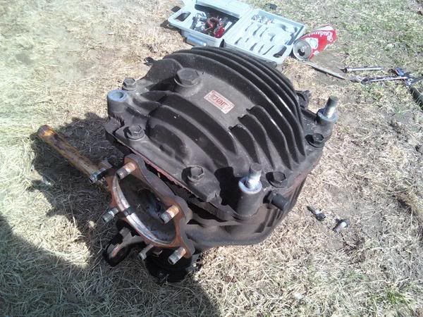

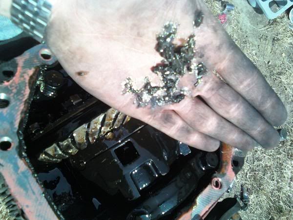

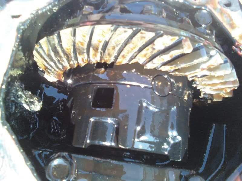

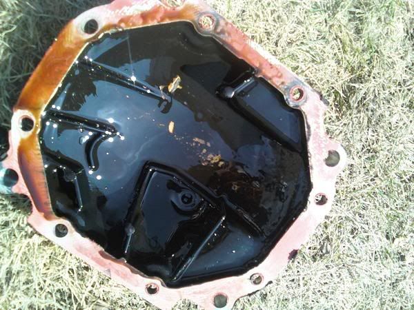

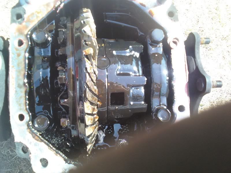

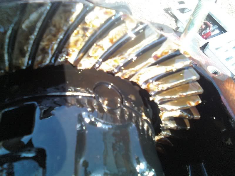

Alot more progress should be done tomorrow, i still gotta take the rear end out since i snapped the fucker :(

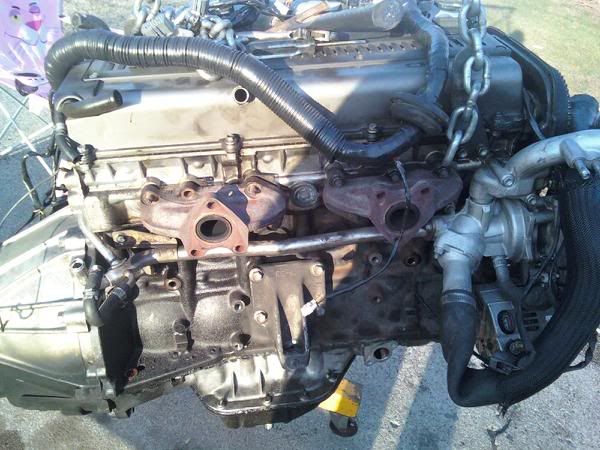

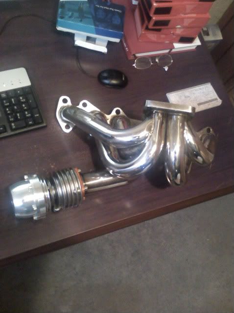

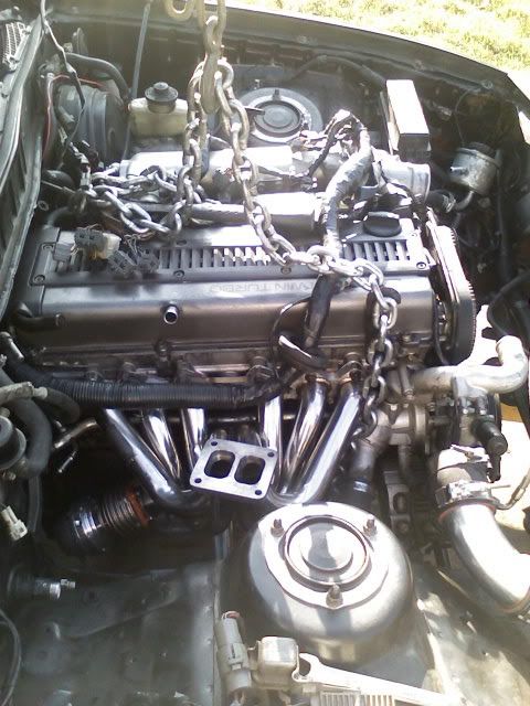

just FYI, i used to use that same manifold, the wg runner needs to be shortened something fierce, as it sits, that wastegate will damn near touch the firewall
how big is that turbo? looks in the 70mm+ range from that head on pic

Yes sir i was aware when i test fitted the mani that it needed to be shortend. :) thanks for the info though! BTW it a 76 mm Turbo
More progress guys :)
Wastegate pipe shortned
Custom making the wastegate flange so we can weld it on
The flange
Flange welded on ,sexy eh ;)

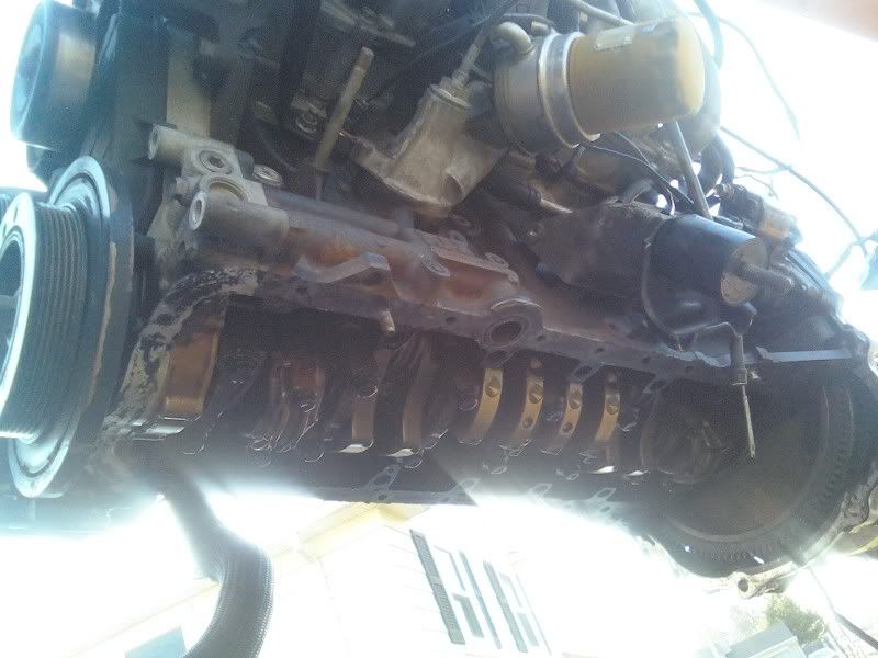

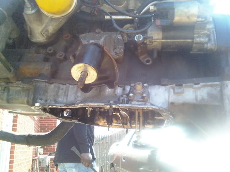

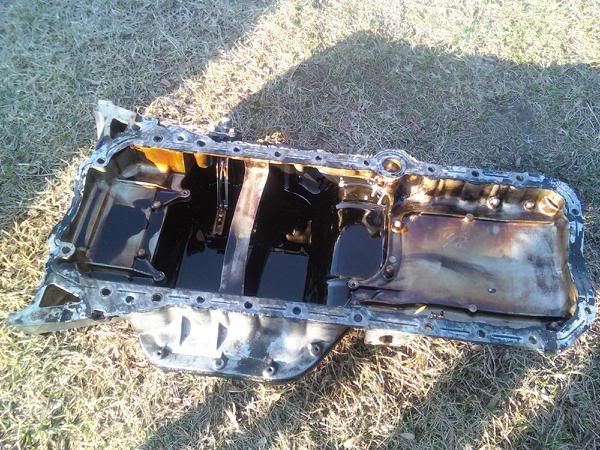

Oil pan off
Mid Pan off to get welded
The is what happens when you do a burn out not knowing you have a motor mount MISSING!

Im looking at a different options for now, im trying to see if i can fit a different pumpkin in there with slight modification to the subframe. hmm..

I got my oil pan patched up nice and installed, also got the wastegate on the mani ready to bolt on :)

I had a member PM earlier telling my that the way this manifold is designed, it wont clear for a down pipe !!
Thing is i shortned the wastegate pipe about 3 inch. and welded a new flange on there. i HOPE i dont run into that problem, he said that hed recomend routing in downwards :(
Ill have to see for myself i guess, id hate to have that hold me up for another day or 2 :(

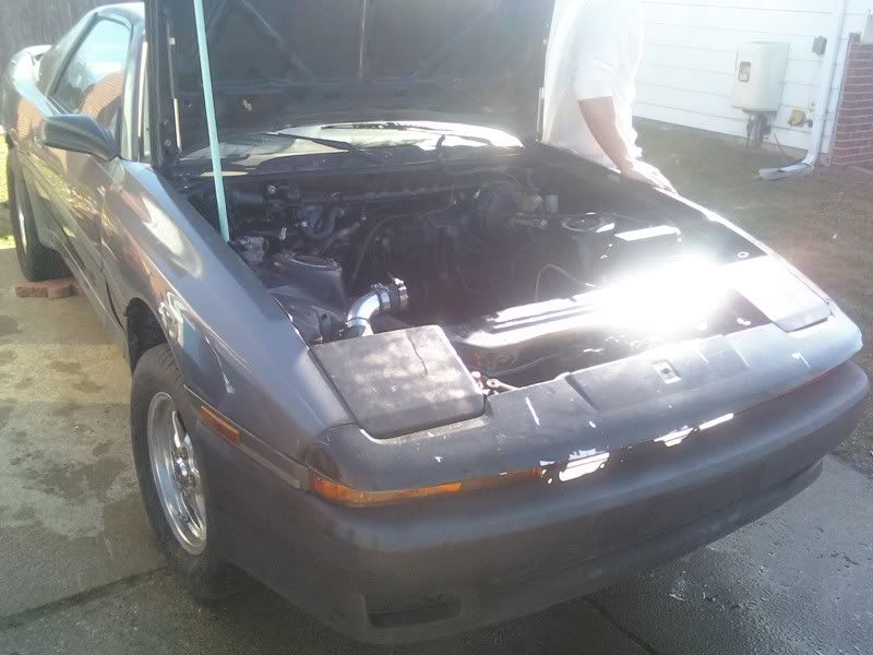

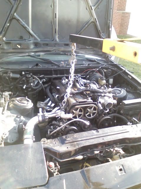

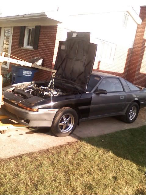

Ok guys more progress :)
Got the motor in and bolted up. i just have to install the radiator and some hoses and swap out the rear end tomorrow and i can have her running.
Installed the mani/wastegate, btw if yu shorten this pipe 3" your good to go, it will clear the firewall and clear for a downpipe!
Still need to adjst the compressor housing on it, but its coming along quite smoothly so far !
Tomorrow i will be installing the new rear end, and maybe take it out for a quick spin before i install the new fuel system.
