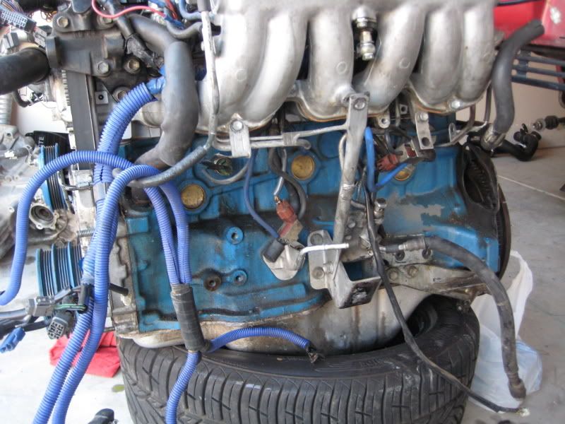

Ohhh, i see what you mean. Here is a side view of the engine block.

its easier to see on the exhaust side. you will have 1 line in between each cylinder and 1 line on each cylinder.

im saying no (its the weaker block) cyfi6 but post an exhaust side to clarify.... you asked iirc
