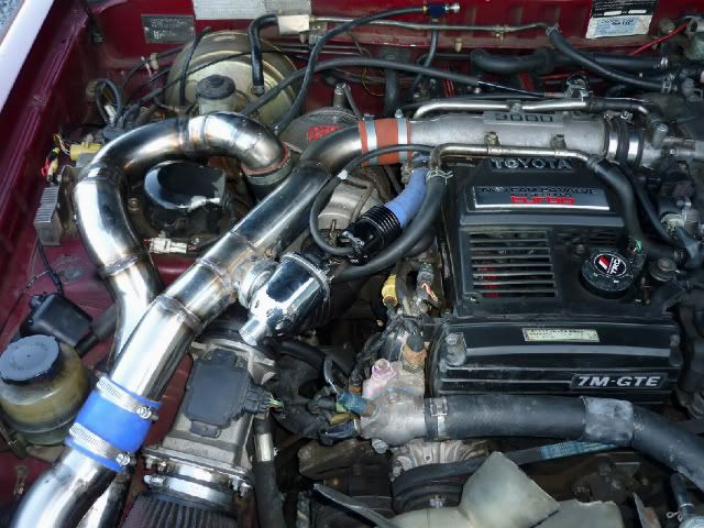

Now rockin twin BOVs:
:D
I've got the Turbosmart one recirculating, and the HKS SSQV (fake one, but hey it works fine) venting, but I have the HKS recirc fitting in there if I decide to recirc both or just run the SSQV eventually.
Sounds good, not obnoxiously loud, and the best bit... NO MORE COMPRESSOR SURGE :) Yay.
