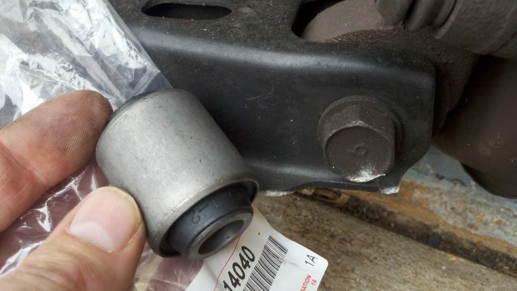

The ES kit does NOT have a replacement to the spherical bushing, I can gaurantee you that.
This is a new rear oem bushing:
And this is a new oem rear spherical bushing. Wanna make sure you're talking about the right part.

must be a newer kit they are offering now, just got mine in from DM. Bushing in the picture is for replacement of the bearing. (which you shouldn't use anyways)
