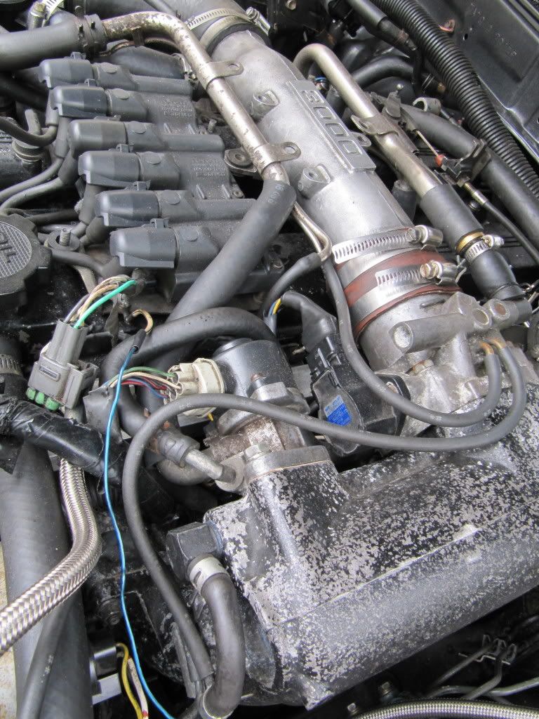

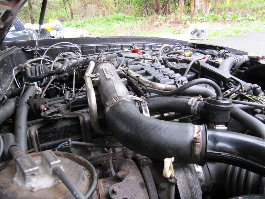

im goin outside right now to take a pic of my pcv hoses, make sure your dumbass mechanic didnt route your coolant into your intake.....
