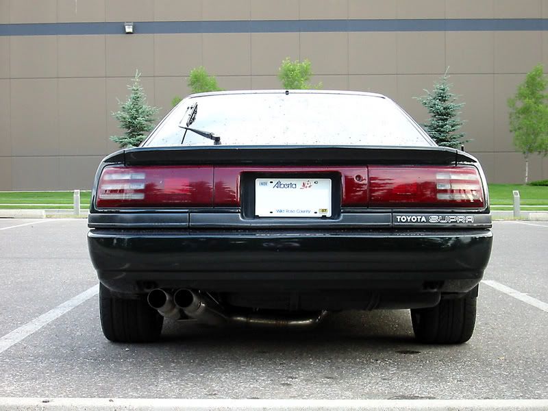

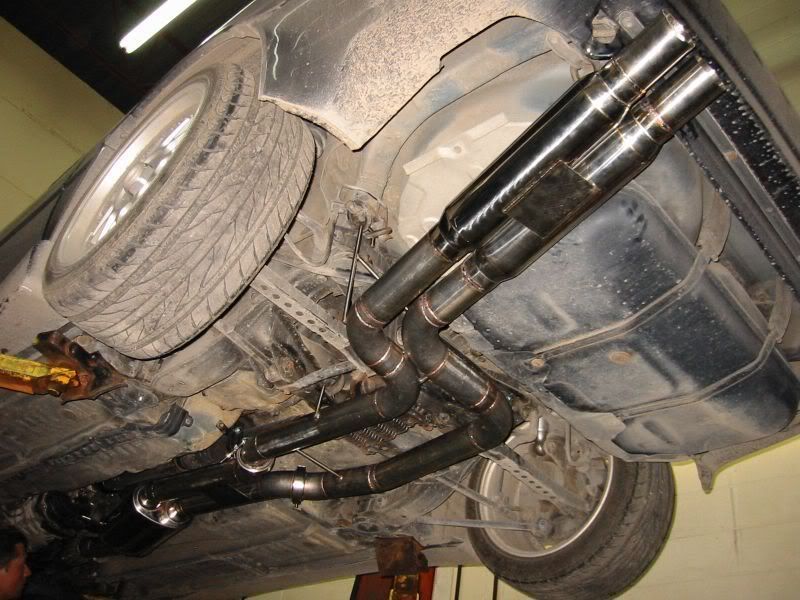

Just finished my fully custom exhaust for my NA. All i did was get 5 ft of strait 2.5" from the local shop along with a couple flanges and then got a 180 degree bend from summit and cut and weld, lots of little cuts and trial and error. Then got some steel rod from the hardware store, put it in the vice, heated it up and bent it for the 2 hangers on the pipe itself. I like how it came out, the muffler is a little loud for my likeing but its not too bad unless youre pinning it. Enjoy! BTW this is a vibrant muffler, comes painted flat black.
