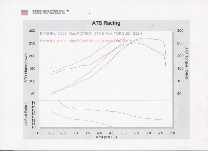

Heres my bros dyno. red line is the stock afm, blue line is no change other than swapping out the lex afm. nothing else. mods are intake, exhaust (catback only stock cat), lower hardpipe, blitz DD and this oddball turbo ;) (its a t3 hybrid with a garrett center section) AND THATS IT! so look at the graph and tell me you want that blue af....
Yeah...don't do that, it's not a good thing. That's a lot of air getting in that isn't accounted for. Don't do it unless you have the means to compensate fuel for that unmetered air.

this was only a test and to prove to people that just swapping the lex in is not a good idea. heres some concrete proof for all the people that say you can.

moorman, how sure are you that you have the correct afm? because according to my calculations, using 40psi as base pressure, youre getting about 12% more fuel by bumping to 50psi. the lex maf is supposed to be 25% bigger and you still trimmed fuel another 18%. I know the stock ecu runs pig rich but 30% plus is ridiculous. btw, are you sure the second is the best tune? 13:1afr at peak torque sounds on the lean side
