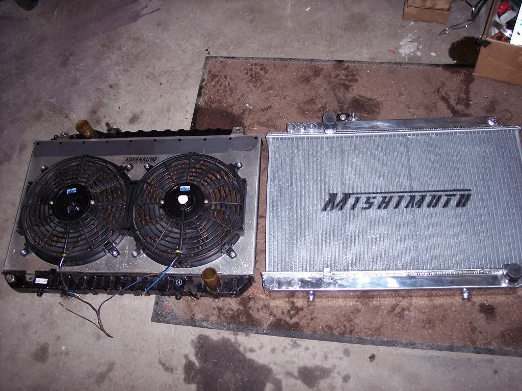

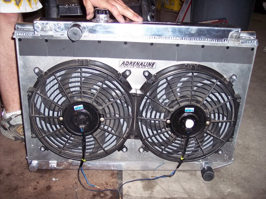

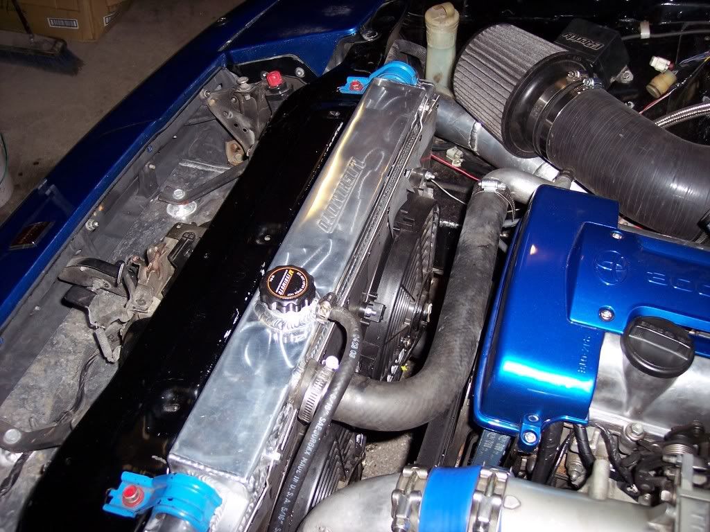

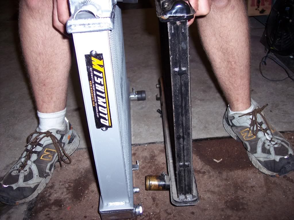

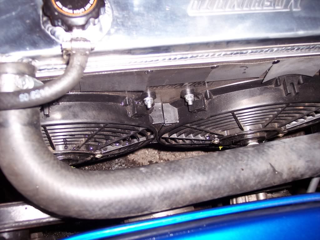

I was having cooling issues on hot days when doing a fair amount of boosting. After asking around, Sean, aka funkey_monkey58 and Rob aka 92nsx highly recommended the Mishimoto aluminum radiator. Got a sweet price from Supra Sport. As many of you know it's a direct drop in swap. For Sean and I, we needed to move a few inter cooler clamps around, took less than 30 minutes for the whole swap. He has done this so many times in the past, it was really easy. I later took her out to get some more E85. I romped on her a bit, but not too hard. Tonight is cool perhaps 70 degrees. No heat issues. Why do the guys in the trucks with the loud mufflers think they can race me and have a chance. Honestly, I am ready to do battle with a Ford Lightning. Photos of install below. BTW, I have the electric fan set up and shroud sold by Adreneline on the group buy section, highly recommend. She bolts right up.
Dan
