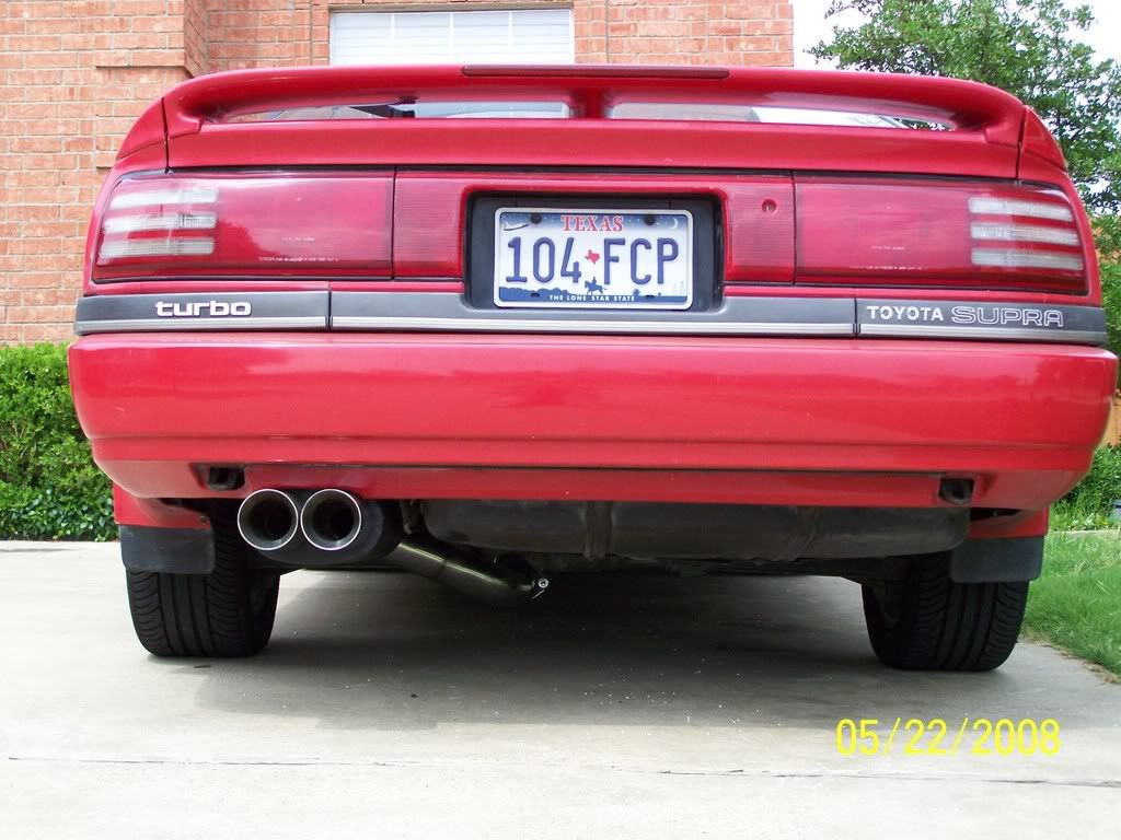

That's the guy we're talking about, and yeah he did a really great job. The pictures I used in photoshop were his car, with his LEDs as work in progress.

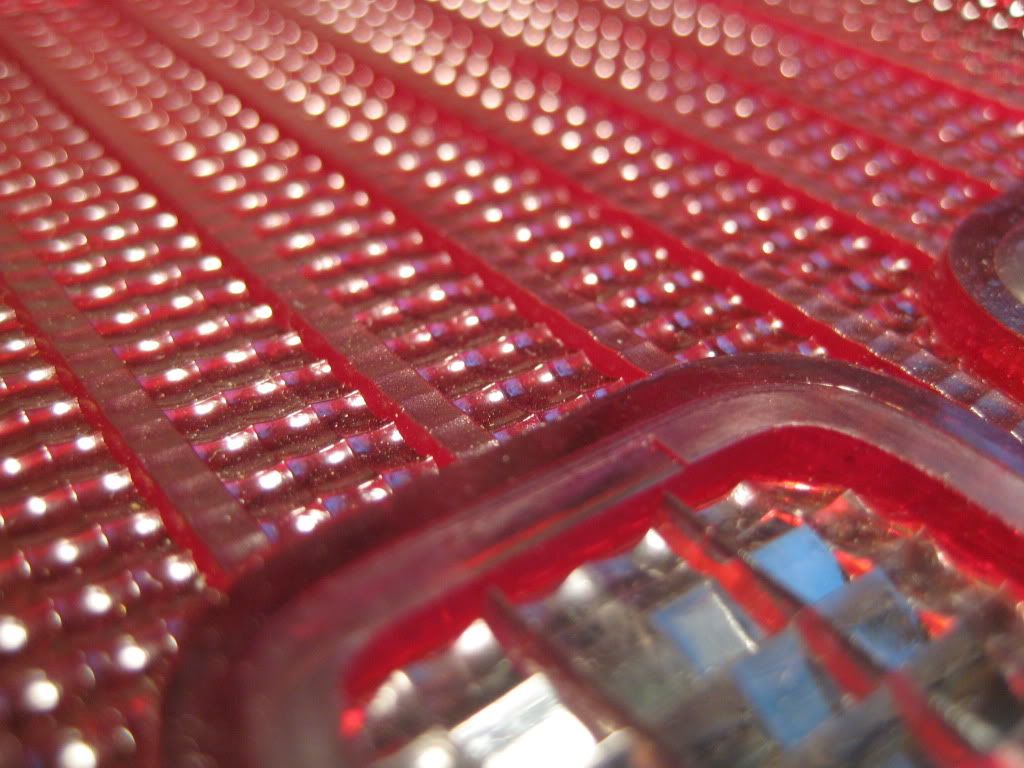

I actually tried to light up the center section, but found it impossible to remove the silver paint from the inside of the center lens and have it be clean enough for light to shine through cleanly. Not only is it very difficult to remove the lens itself, but I ended up destroying 2 of them trying various paint remover products/methods. Your first pic was actually my original intention to build, but it took so long to solder so many LED's that I settled on a simpler design. Also in the end, I was glad to have it look a little more OEM and a little less like a spaceship to avoid unwanted attention from cops.
The Suprflux LED's I used were so damn bright, I had to build 2 pwm's to dim both the brake and park circuits. This required a relay to be built into the switching circuit so that the 2 pwm signals would not mix when the brake was applied with the parking lights on.
And yes, the square reflectors scatter the light a lot, and can easily mess up your pattern.

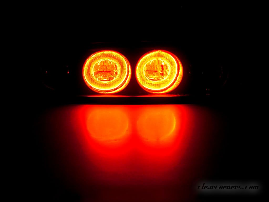

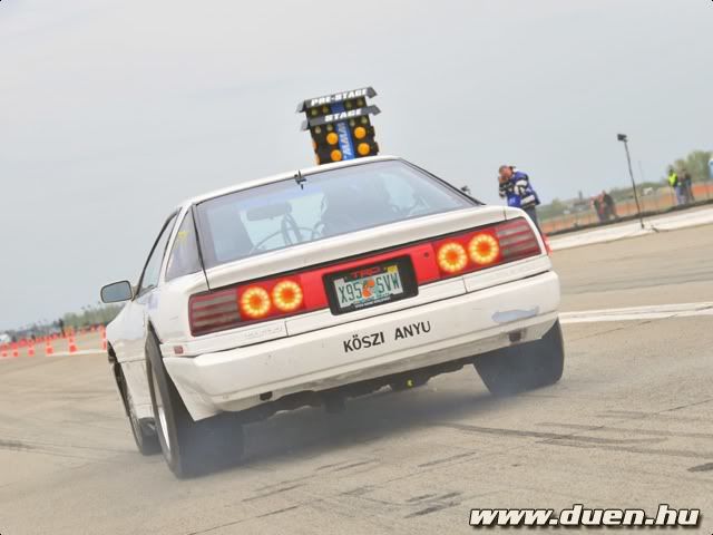

I like the stock lights but if i had to pick one of yours, the Circles.

I like the circles, I used to have them on my taillights (not LEDs though), using 4" PVC piping cut and inserted..
looked good, but I eventually went back to the stock look..

Hmm. Well, as much as I liked the bars, I may just do circles so that I don't have to experience the process of removing old paint, just to have a lens that is of different translucency than the two sides. Poodles, what was your secret? Do you think that if you had similar bulbs behind your center section, it would show up similar to the sides?

As far as circles are concerned, I think there is a way around that square diffuser. If the entire circle was diffuse light instead of pinpoint lights, and you had a frame that prevented scattering outside the pattern, the section that ran into the diffuser wouldn't look out of place. For example, in this picture, the outer rings are diffuse, solid led light:
Perhaps a form like that, placed very close to the lens would still give a clean circle of light even if it did contact the diffuser. I don't necessarily need a "pinpoint" type of tail light, I think I like solid diffuse light better.
