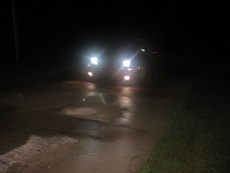

my 10k Hid's in a ebay h4 housing...
If you need help wiring up everything let me know. I used two relays(one for the hadlights and one for the foglights) and wired it all up from that.

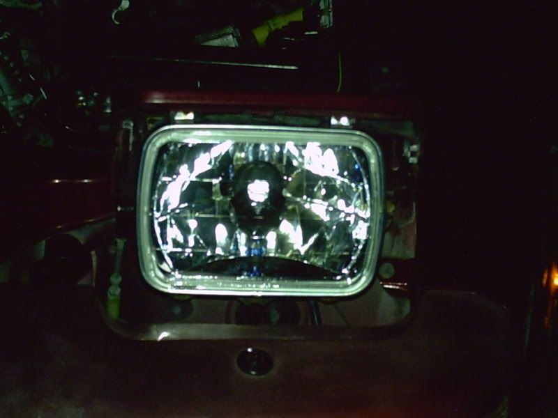

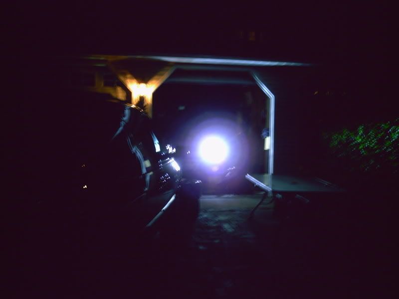

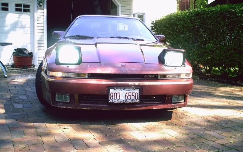

here are my Hella housings with 7k HID's
no flash
with flash
this was only taken about 20-25 ft. from my garage wall and my driveway slopes down, so the front of the car was aiming high. i rarely got the flashing of bright lights from on coming traffic, but it has happened before.

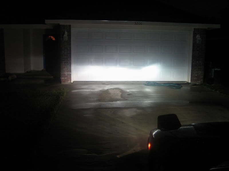

Mine are like noah's ^^
People always bitch and moan about the glare over the cutoff... but a normal DOT sealed beam has MORE glare in that area from what I saw when I did my conversion...
