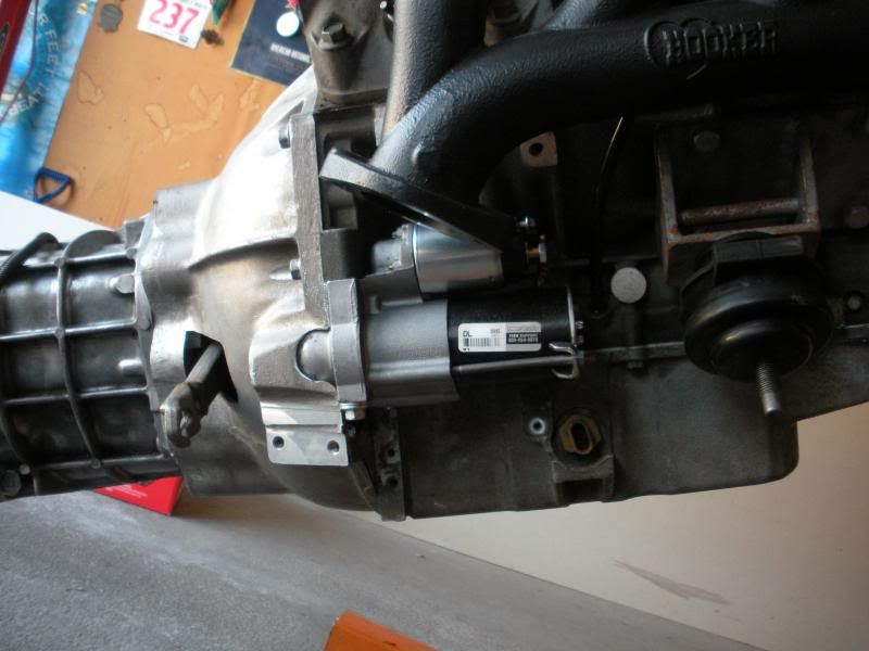

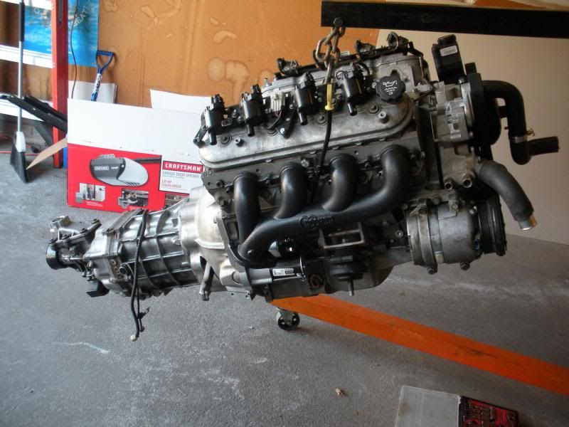

Time for an update. I pulled the engine for what I hope is the last time before the first start up. The high torque starter I was using was not cooperating. It is able to be clocked and no matter what I tried it interfered with either the crank sensor, the exhaust manifold, or the slave cylinder. I went with a stock starter and had to grind away at the bellhousing.
Hopefully everything will hold together.

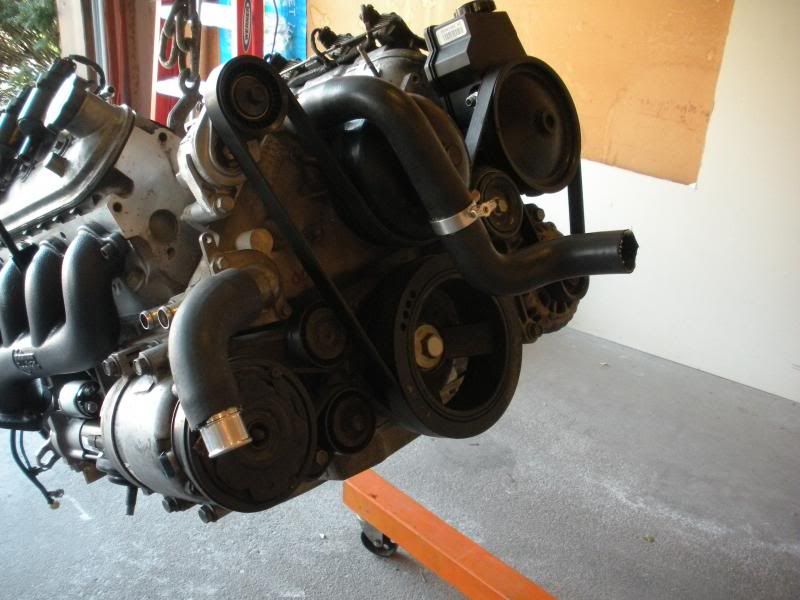

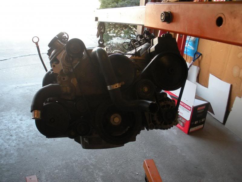

I also strapped on the A/C compressor while she was out.
Last but not least I installed the LS2 corvette oil baffle. The L33 oil baffle didn't allow for the oil pick up to be bolted up correctly so for $30 I got the correct piece. No pics but I was cleaning the garage while the engine was out and was glad I stumbled across it. I also found the final heater hoses I needed and a few other odds and ends.
Hopefully the weather will stay above freezing and I can get this thing bolted back together.

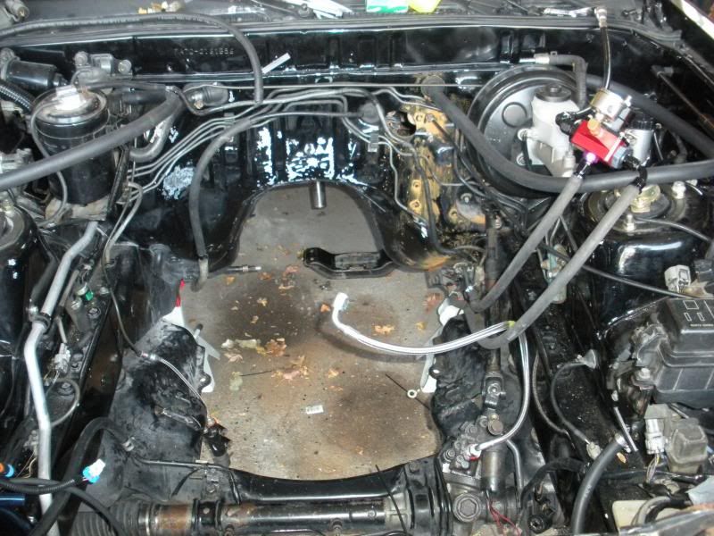

Pic of the engine bay and the paint repair I will need to do after coaxing the firewall into place.
