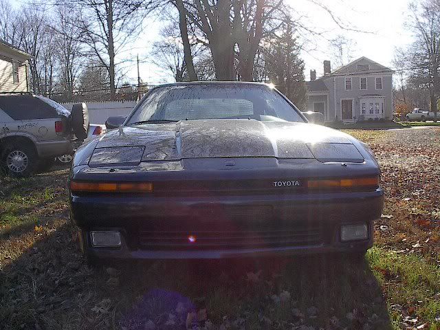

Ok here she is when I got her.
You cant really tell from the pics, but there is a mild side swipe on the drivers door, bad bodywork, bondo cracking on the passanger pillar between the door and hatch. Other misc door dings, dents etc. :3d_frown:
Forgot to add I got her with 121,000 on the clock for $2000 1987 turbo 5 spd hardtop

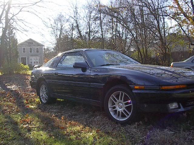

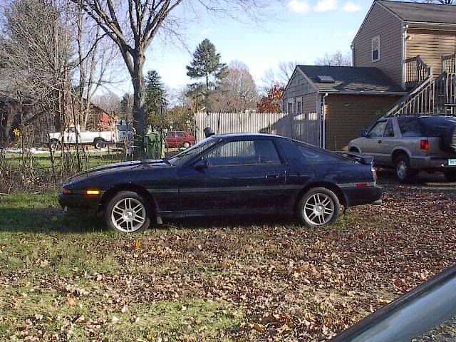

Ok, now for the front :evil2:
Removed pretty much everything in the front. Had to sorce a 89+ nose cone $75 and turn signals + little grills $40 This wasnt too bad, I might drill out the two front holes in the bumper and raise it a 1/4 inch or so, its a tad low. I re-used the stock cross braces for the bumper. I attached them to the fiberglass bumper with 3000lb epoxy, its not going anyware trust me . I am going to have to use a bit more bracing for the front as it still has a little flex to it at highway speeds. I have some aluminum I am going to use to make brackets to make it nice and stiff.
Oh yeah the rims and tires I got for $200, tires are pirelli's 235/45/17
Forgot to add 89+ spoiler $120, 89+ tail lights $100. 89+ brake light failure sensor $10, crossdrilled rotors and pads $200
So far total this round $745 whew!
