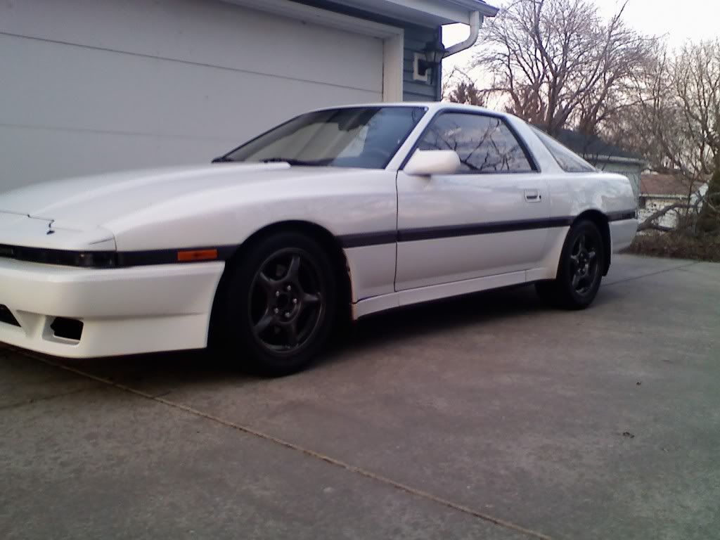

update: i went with tokico blues and h&r springs just ordered them today along with some bridgestone re-11's should be sticking like glue

UPDATE I have installed every thing and couldn't be happier about my set up so much grip and control very responsive, no understeer very little oversteer unless i purposely kick the backend out, looking forward to track/autox in the coming months. Thanks to everyone for the input.
