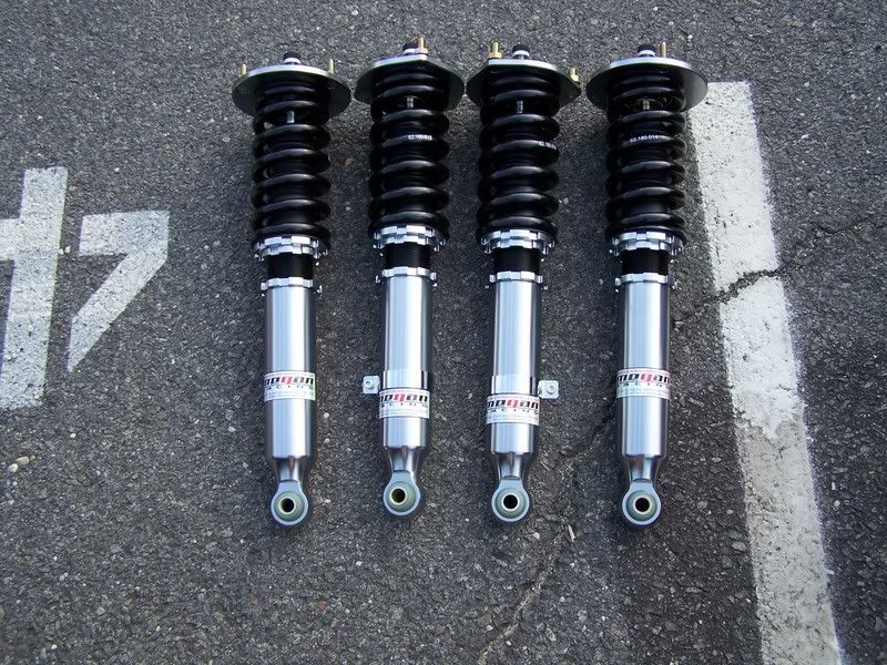

Here's what mine look like. Also take note of the top of the strut. They are shaped different. 2 middle ones are the fronts and the outside ones are the rear.

ahhh mine never came with the bracket :( :( :( :( those megans look nice.. What spring rates did you get? how do you like the megans? My mounts aren't shaped like ur fronts they are round like the rest of them :( only difference its a tad wider

18kg Front and 14kg Rear. I absolutely love them. I use my car for DD and I have it set on full soft and it rides very smooth. I put them on full hard and drove around and it was stiff as hell. Almost made me sick to my stomach.
