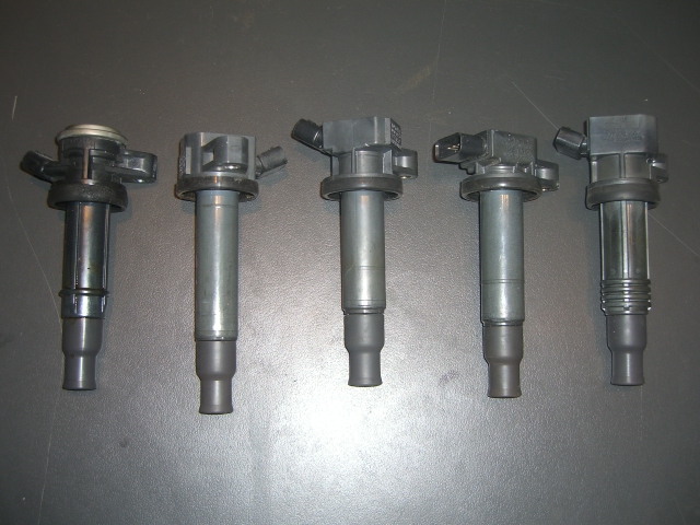

Whats the partnumber of the coils BIC and honestabe use pls chime in because in this link http://www.motec.com.au/forum/viewtopic.php?f=19&t=374
The part number on the coil is denso 90919-02230
Butt i can get a set of coils but its an different partnumber the last number end with an 9
This is the partnumber of the coils 90919-02239 are they the same ??? can i use them ?
Bic use late Mr2 coils so i think ( 90919-02239 ) is the right one (somebody correct me iff i wrong)

now what i've read 2 times and seen a picture of 1 time, the 1zzfe seem to sit an inch over the valve covers on a 7mgte now how about this, i got this info from http://www.ae86drivingclub.com.au/forums/showthread.php?7098-Toyota-Coilpack-info-thread but in short these are all different styles of 1zzfe cop units
These were put with the rubber seals more or less in the same plane so you can get an idea of comparative height.
Source vehicles and part numbers from left to right:
90919-02227 ST215 Caldina 3SGTE
90919-02230 GXE10 Altezza AS200/Lexus IS200 1GFE vvt-i
90919-02239 ZZE120 Corolla 1ZZFE
90919-02240 NZE121 Corolla 2NZFE
90919-02236 SXE10 Altezza RS200 3SGE Beams dual vvt-i
you guys think a shorter one of these will work height wise on a 7m?
