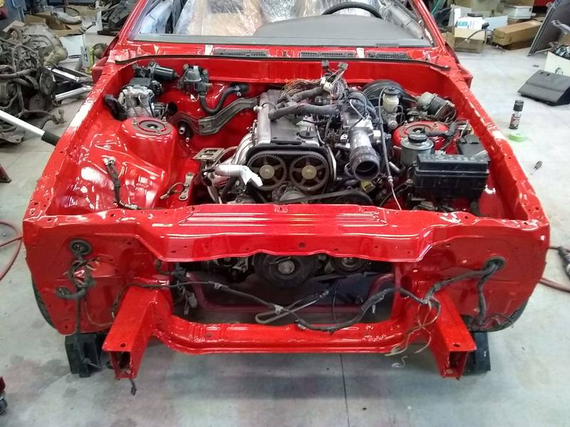

Lots of reassembly, finally. Under the hood...
...and under the dash.
I had a number of "what the heck was I thinking" moments due to my overzealous disassembly. Like "why did I take apart the fuse box"?, "why did I take apart the relays?", "why are the brake booster nuts not with the brake booster? <-- I still haven't found them.

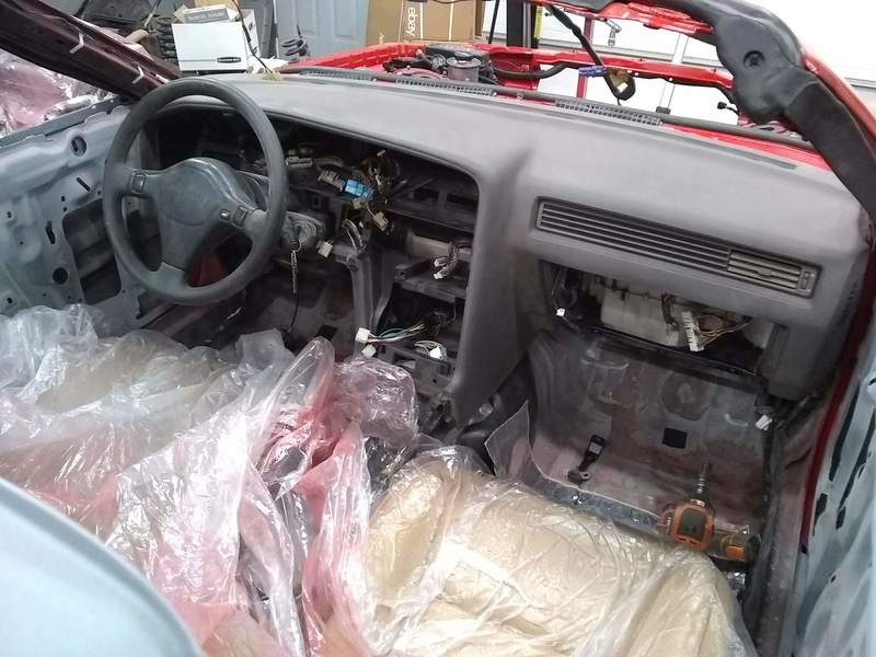

Got everything under the dash installed as well as the dash itself. It'll have to come back out as I'll be painting it black but I don't have time any more for "since I have it apart I may as well...". That is what got me into a now 13-year car project that has barely been touched for the last 7. So right now the focus is to get it back on the road as quickly as possible and work out some other details later.
Also dropped in the drivetrain. The rear trans mount fits over the AR5 nicely, just need to make a bracket. The trans fits in the tunnel just fine with the extra meat removed.

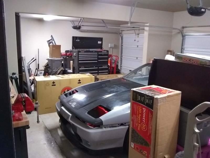

In the new garage. Not nearly as much space as before, but it'll work. This "3-car" is smaller than our 2-car at the last place, plus I had a 26'x36' shop with 14' ceilings. Not any more :(
So...much...stuff
Maybe some day we'll be settled and I'll do something with the Supra, but it likely won't be soon. I'm contemplating getting out of it for good now, and getting something that I can actually drive. Maybe another Z-car or new '86. Or -gasp- a coyote Mustang. At my "spare time rate" it'll probably be at least a couple years before I'll be there with this one.
