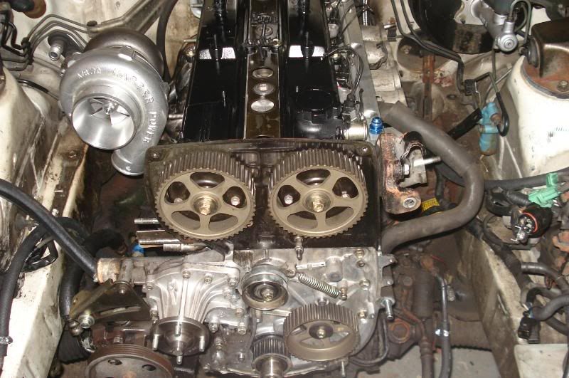

no im going with a felpro for now. im going to get a spare motor to build the internals on and do a mhg on that. the felpro will be fine for now with some arp's

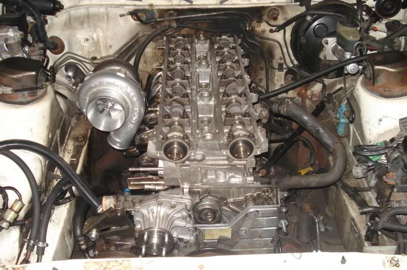

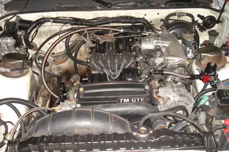

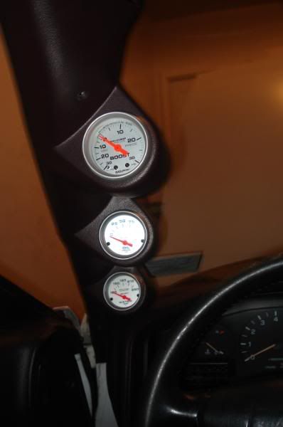

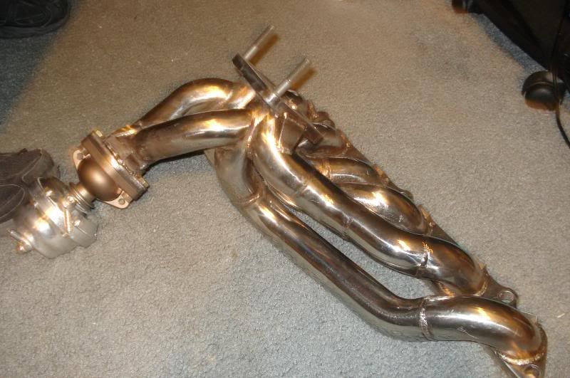

so i got some pics taken today...

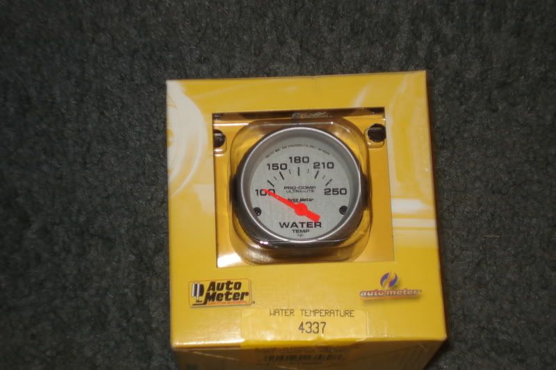

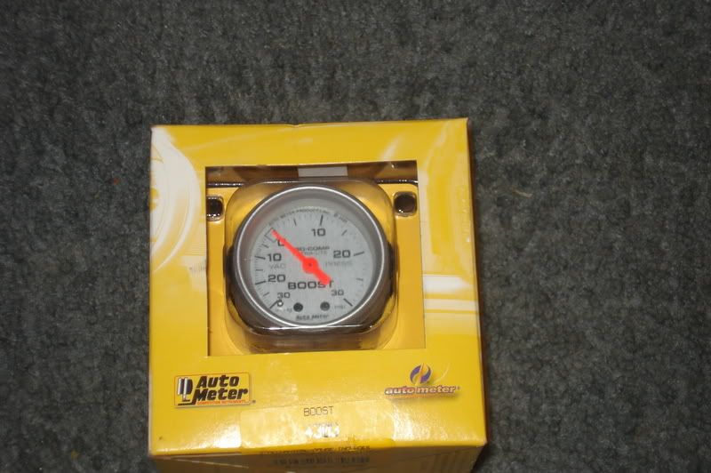

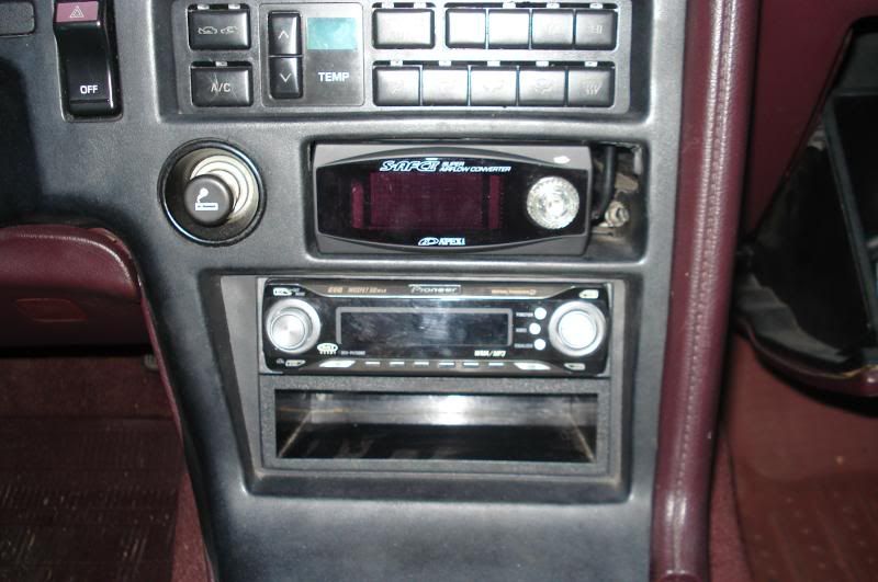

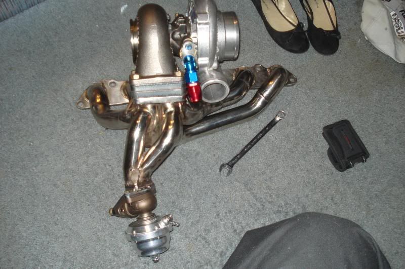

boost, oil pressure, water temp, and i also have an egt. gauge.

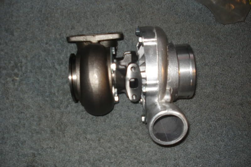

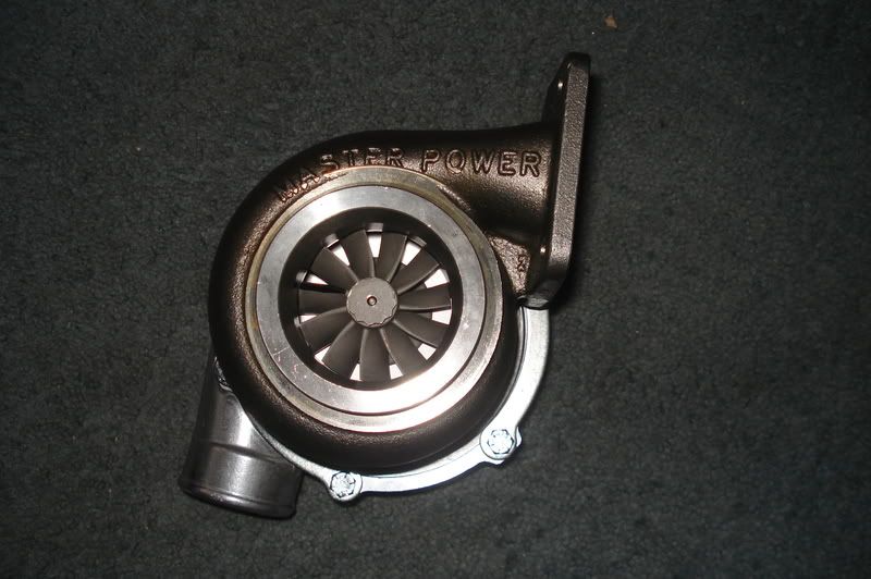

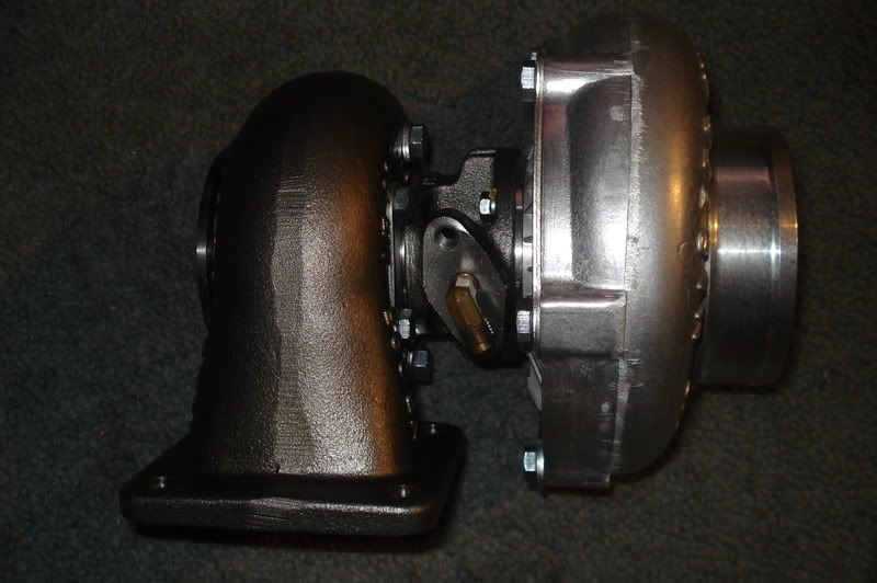

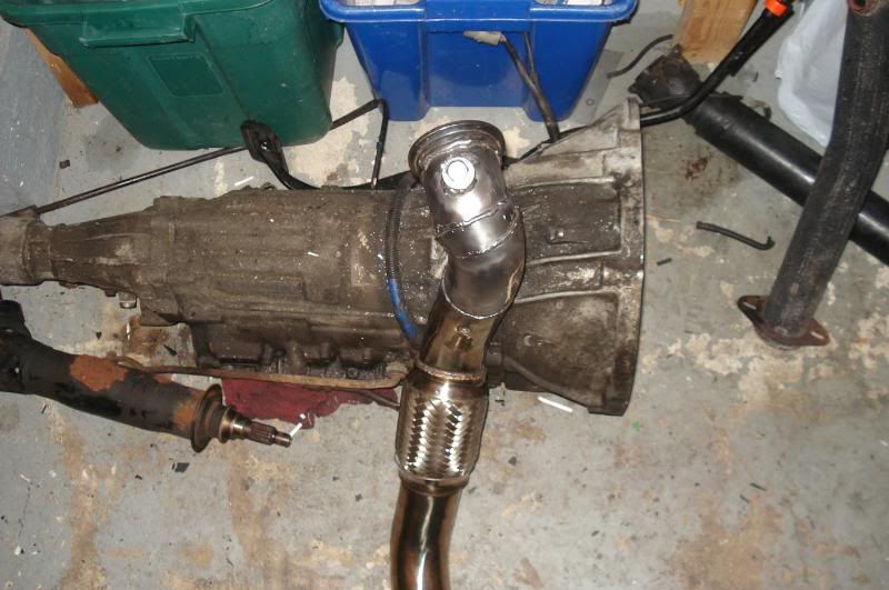

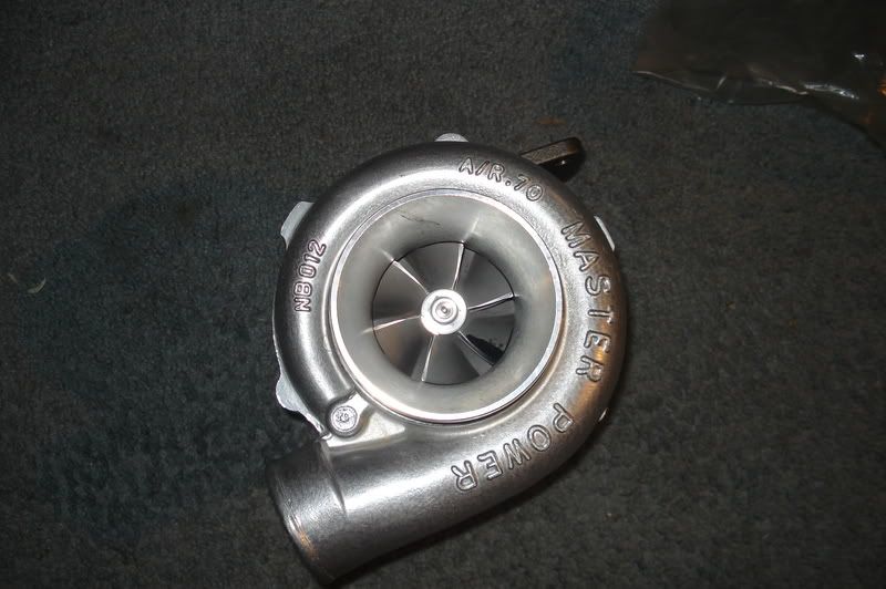

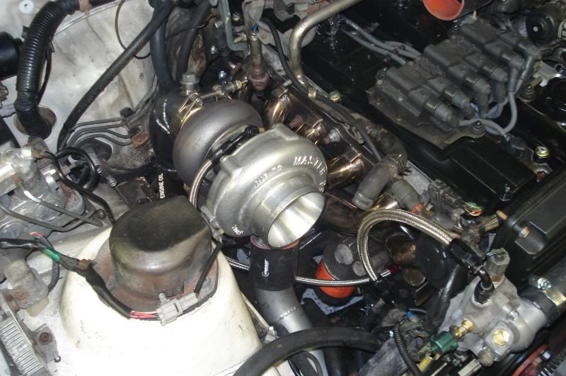

MASTER POWER T70

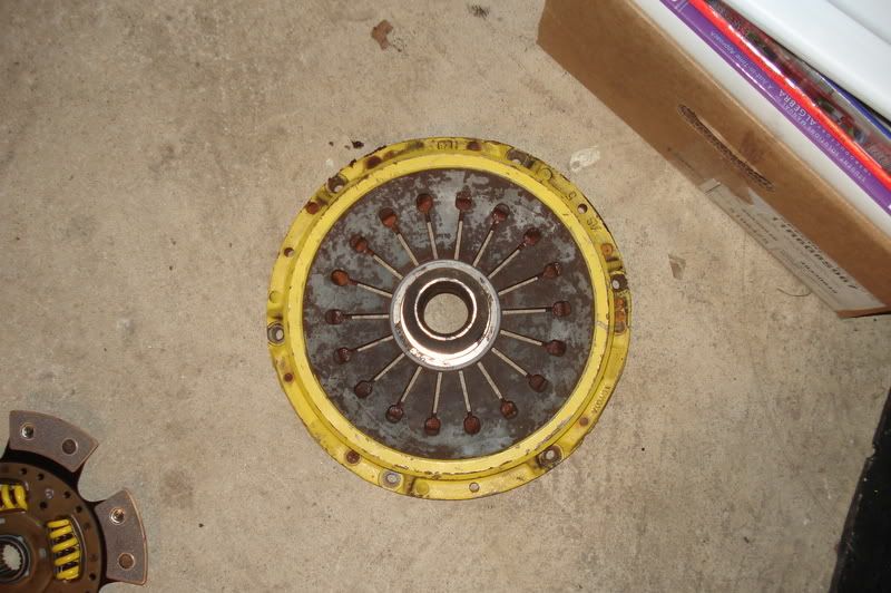

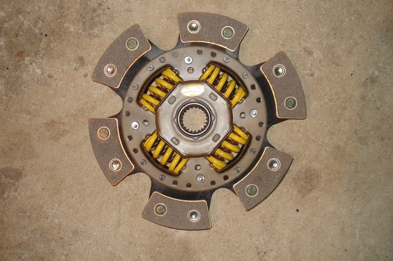

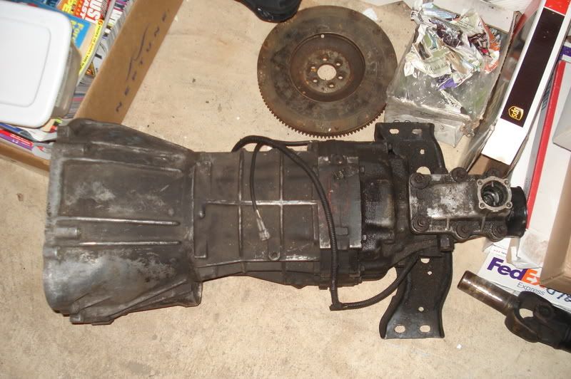

ACT CLUTCH AND 6 PUCK DISK
R154 AND FLYWHEEL

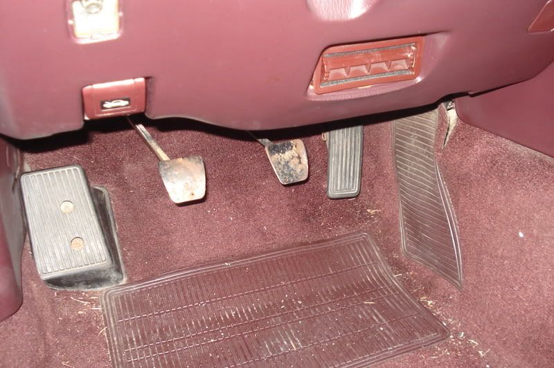

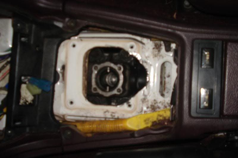

5SPD SWAP DONE PEDALS AND CLUTCH MASTER INSTALLED

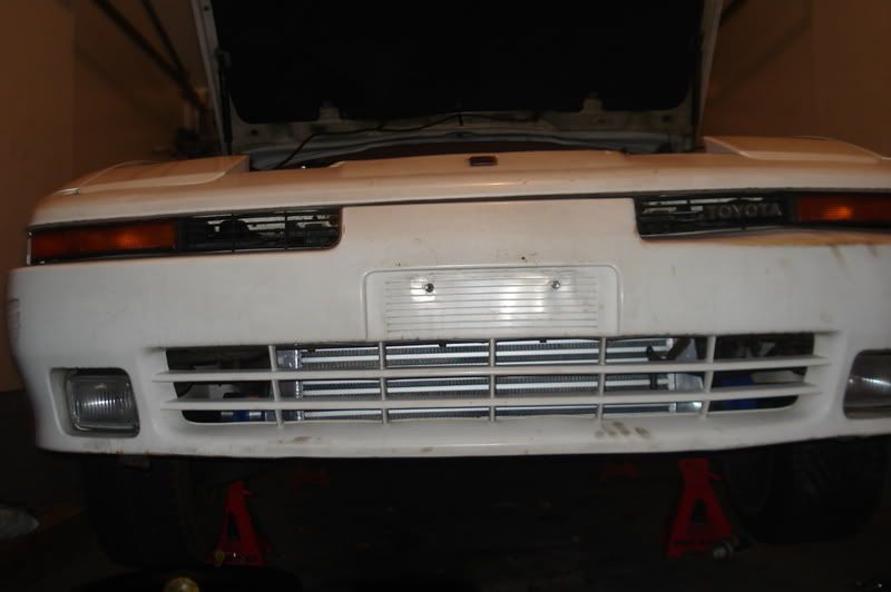

INTERCOOLER INSTALLED

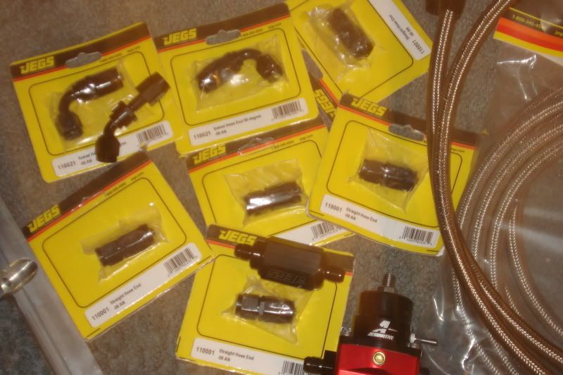

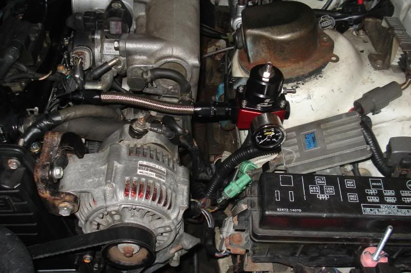

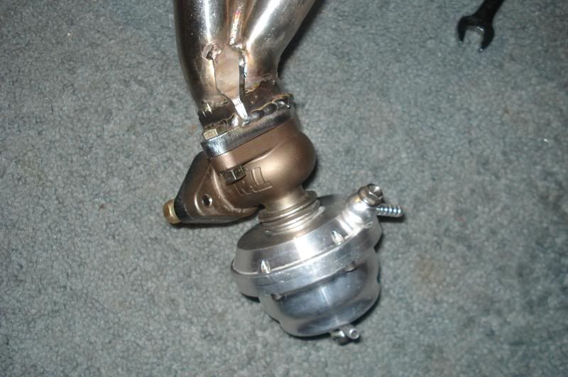

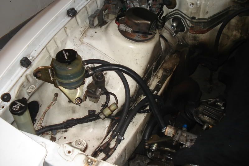

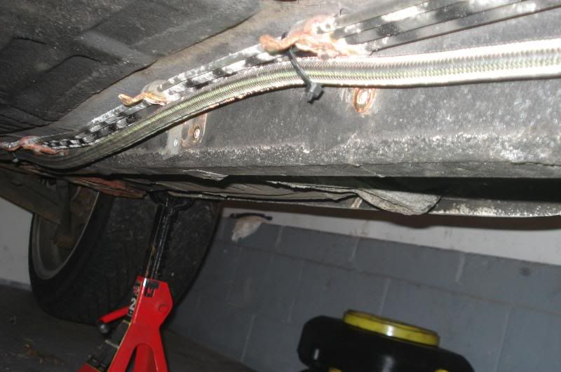

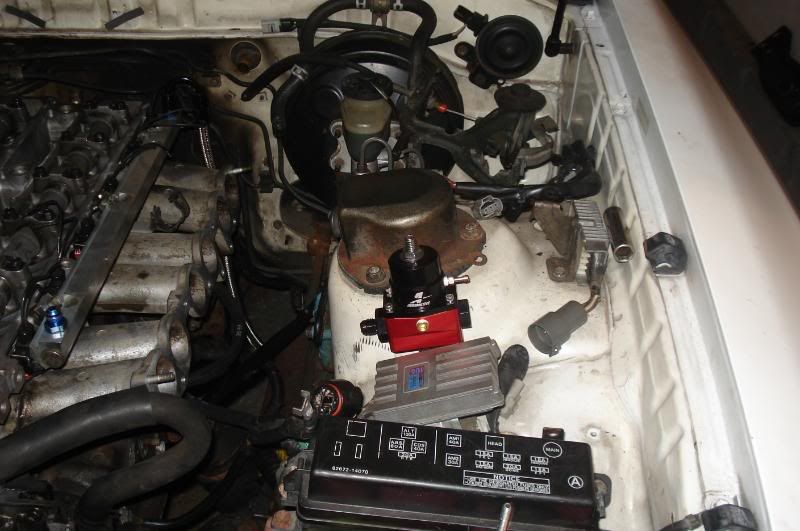

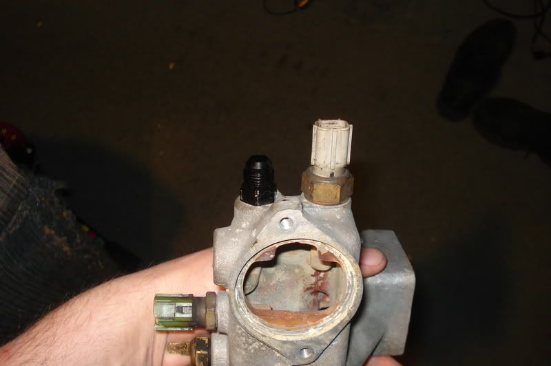

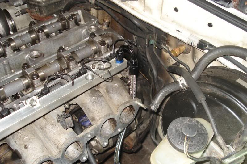

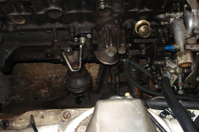

FITTINGS FOR WATER BYPASS

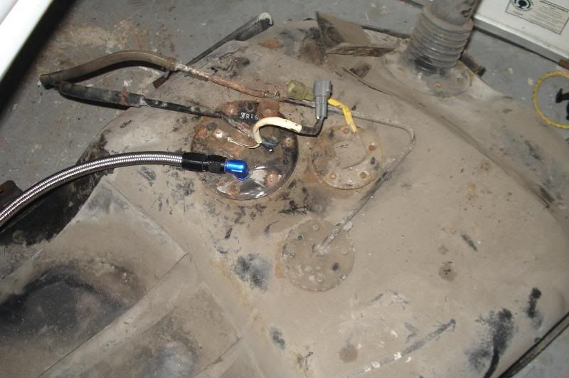

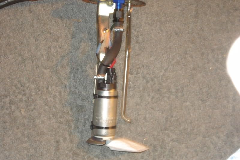

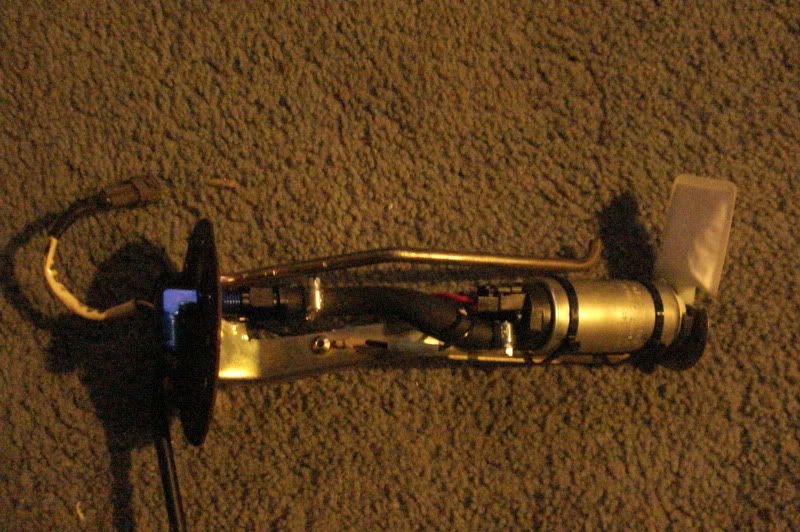

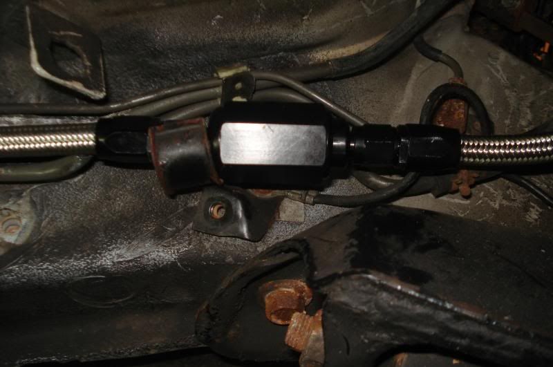

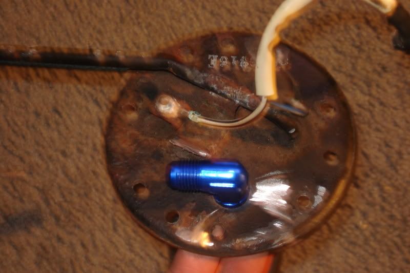

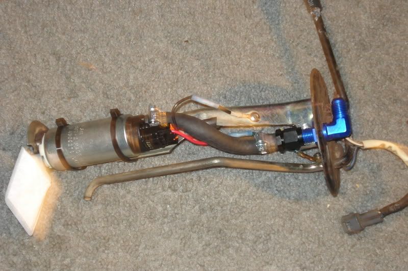

FUEL PUMP HANGER WITH -6AN BULKHEAD AND -6AN LINE TO GO FROM TANK TO RAIL AND MISC FITTINGS AND FUEL FILTER TO MAKE IT WORK

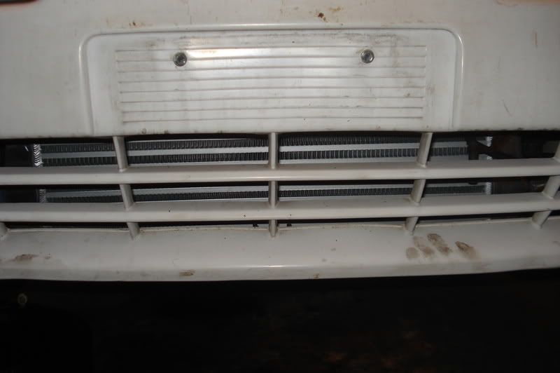

the intercooler is the ssautochrome ebay one 24x12x3. ill be using the stock intake manifold for the time being, and no i will not be using nitrous, just a little meth. :)

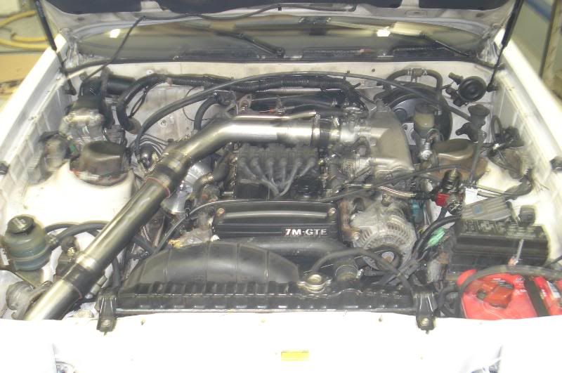

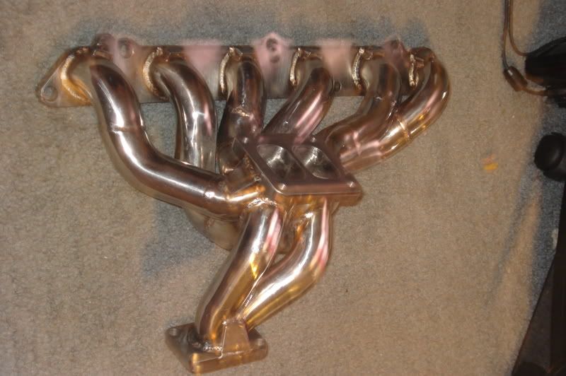

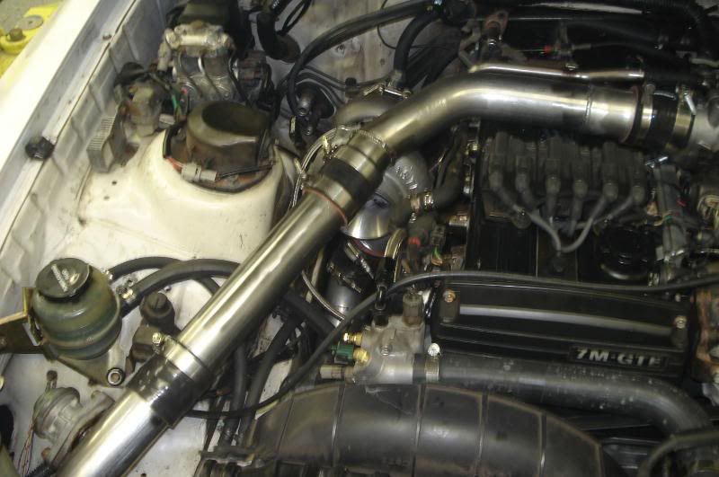

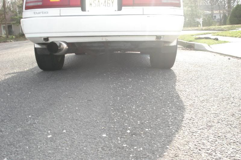

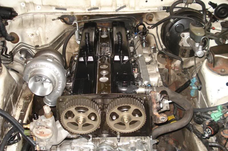

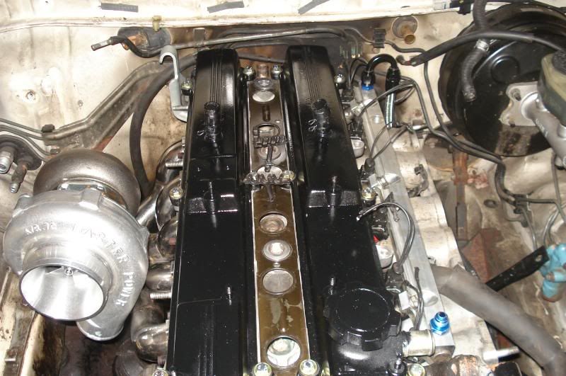

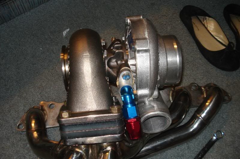

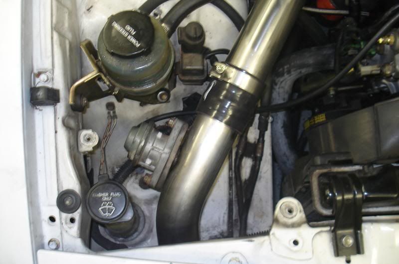

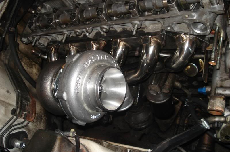

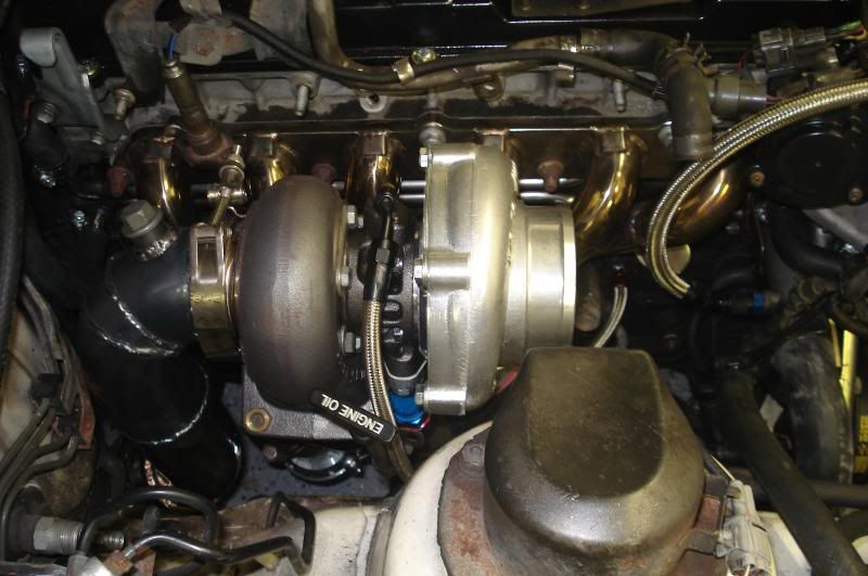

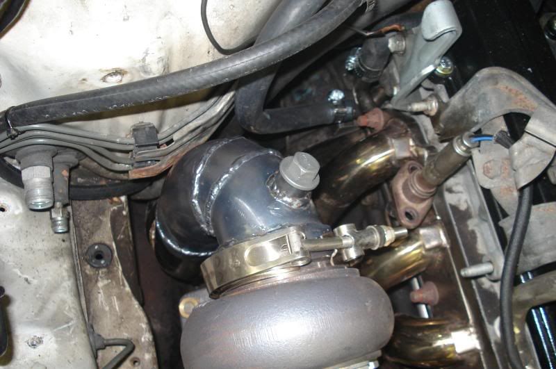

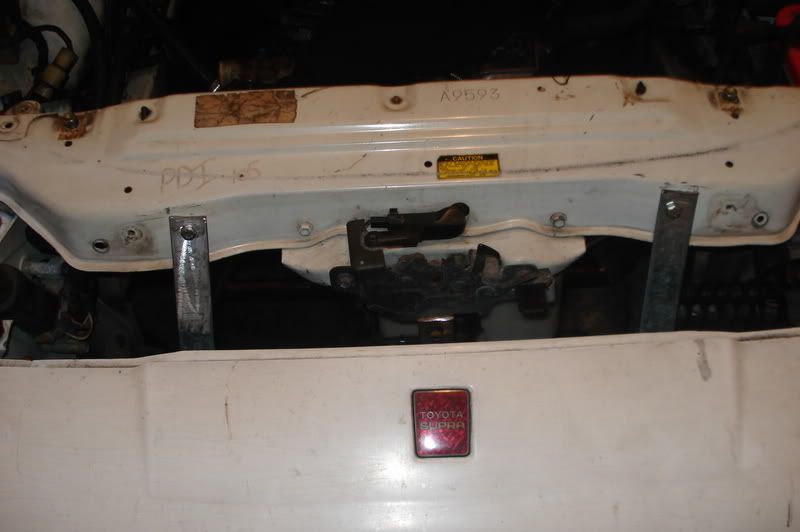

well the car is running and will hopefully be tuned and ready for the east coast meet at englishtown raceway park, this saturday april 5th.
heres some pics of the turbo mounted now and the upper intercooler pipe mostly installed. gonna finish up the lower tomorrow wire in a few gauges and clean up some vacuum hoses, and then go tuning!!

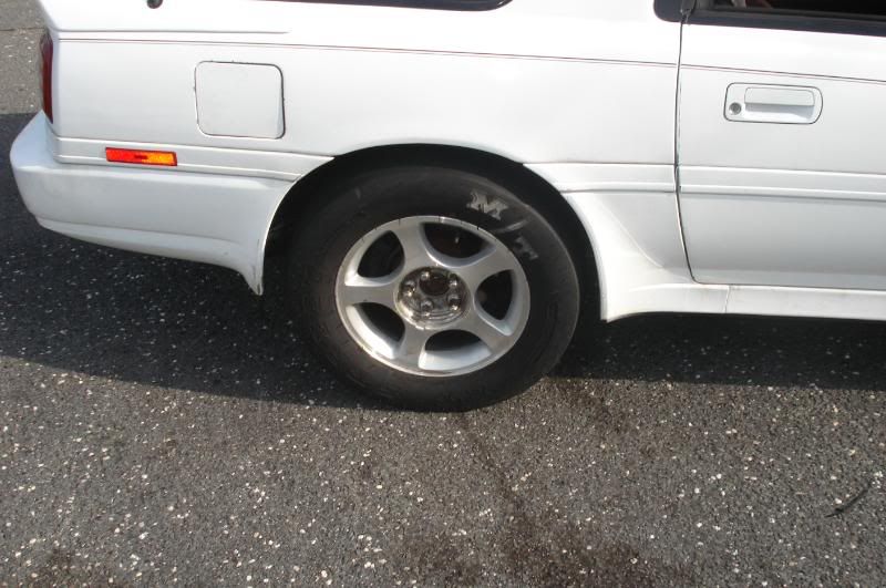

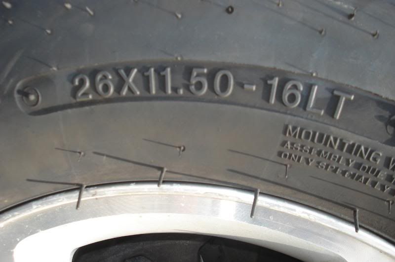

Careful Jimmy! Those tires are great, but will feel like you're on ice with radials up front.
I had no idea you were this close to being done, but I guess that's what that excited message was that you left me.

lol yeah not many people reply to my thread so i left alot out as far as tuning and stuff lol.

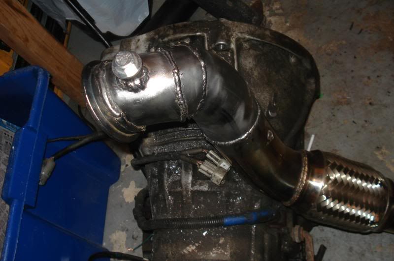

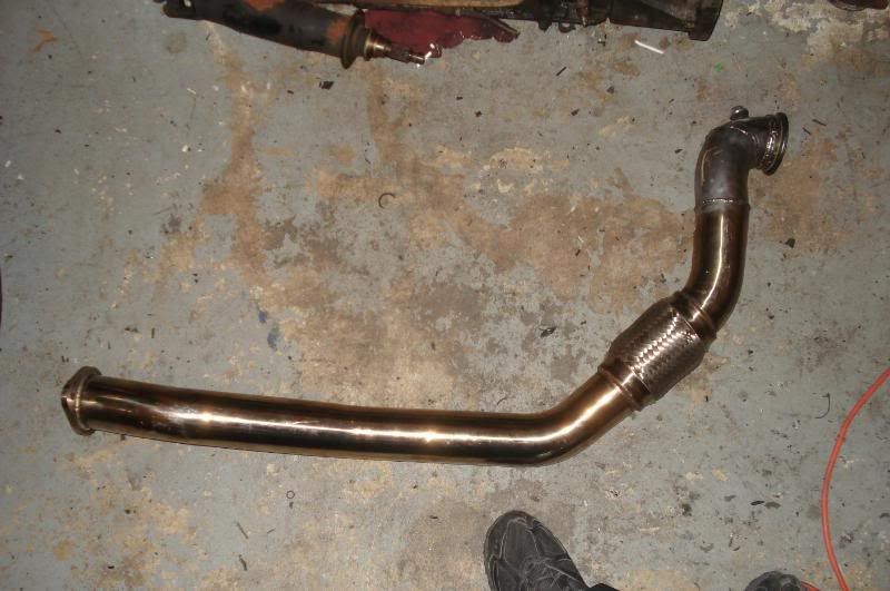

but as for results with the 3 inch downpipe leading into a stock cat and catback and untuned the vpc and afc zero'd out at 15psi and teh best the car went was 12.8@109
there were also a few at 13.4 and such but i have 3 12.8 timeslips.
i beleive with a full 3inch exhaust and tuning even still at 15psi the car should run low 12's.
