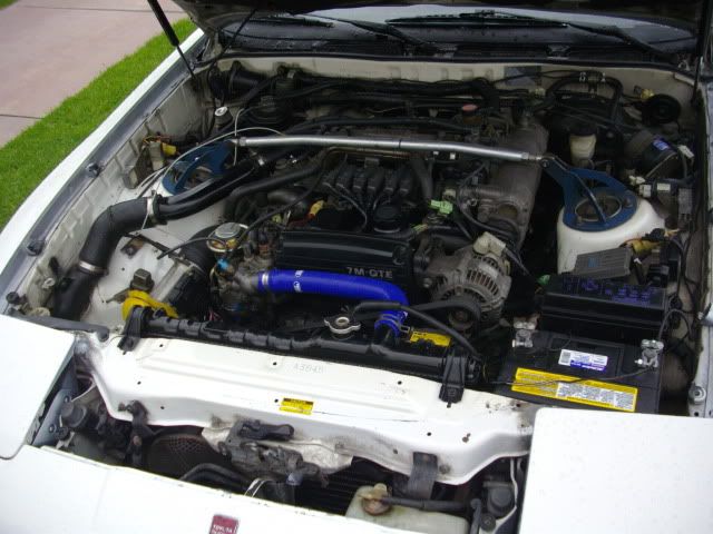

Engine:
7mgte high miles!
HKS intake filter
ARP headbolts
DM down pipe
Custome 3" exhaust
shimmed wastgate 14psi maxed
Samco hoses
Blitz radiator cap
Cusco catch can
new gas tank
suspension:
blown bilstein shocks in front
bilstein shocks rear (not blown yet)
eibach pro series lowering springs
no name funky front strut bar

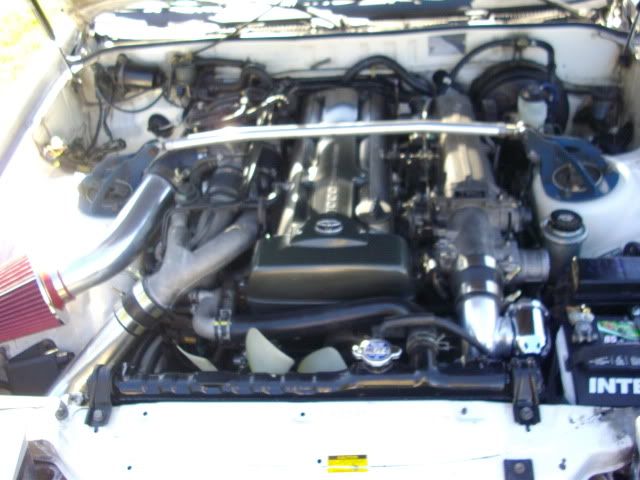

im sorry but is the hks element filter being held on to the AFM with a rubber band? Lol previous owner didnt want to give you the filter cage or something lol.

HAHA, I noticed this while scrolling throught, thats preety rigged isnt.

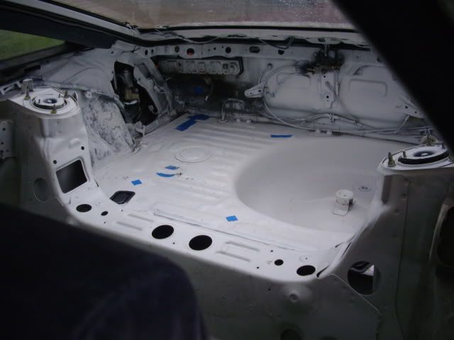

Haha yeah the filter i zip tied on for the time being, i didnt want to buy a legit one since i was going to go through with the swap pretty soon. The Trunk did have some rust where the spare tire was, so i sanded it down and repainted everything with rustolium spraypaint and then clear coated. I also removed the sound deadening rubber mat material stuff from the floor of the trunk, trying to lighten the car up as much as possible. it seams like it has stoped the rust, only time will tell :)

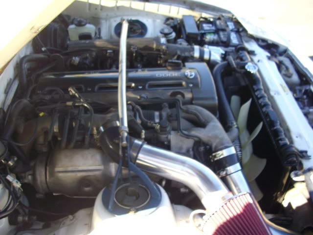

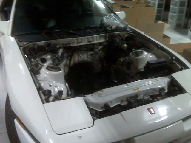

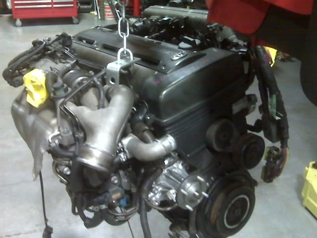

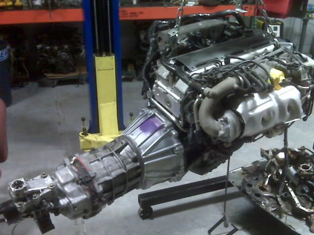

So i took a trip up to Drift Motion today to go check out my car, i forgot my good camera i only had my crapy phone camera. But anyways the 7M is out, Aaron and his team cleaned the engine bay, and got the Aristo 2JZ prepped with new oil pan, 1jz bell housing, new front main seal, new rear main seal, new cam seals, new spark plugs, Action stage 3 clutch (6 puck), Ver. II pulley kit (not installed yet), new Marlin Crawler shifter bushing, changed all my fluids out on the motor and transmission basically the full 60k service and then some. While i was there Aaron explained to me what he would be doing over the next week, i was also surprised to see that he had taken pictures for me of the old 7M coming out of the car. He happily answered all my unnecessary stupid questions and hooked me up with a free DM T-shirt before i left to drive home. I am completely stoked, and his work looked solid! heres some crappy pictures to boot,

Here are the swap details, all these parts were new except for the motor of course.
2jzgte jdm aristo engine (really good condition)
2jz timing belt
2jz cam seal
front main seal
rear main seal
1jz/2jz power steering hose (steel braided)
engine swap brackets
front mount intercooler kit (with bov)
spark plugs
walbro fuel pump
Action stage 3 clutch kit
Marlin Crawler urathane shifter bushing
delrin shift knob
mt 90
1jz/2jz r154 bell housing
1jz flywheel
Version II pulley kit
2jz/1jz water pump
ARP flywheel bolts for 1jz/2jz
ls400 fan clutch
gear oil
Parts that i opted to fix:
new brake master cylinder
new goodridge ss brake lines
Parts aaron gave me for free:
new caliper on front right wheel
new battery
new battery tie down
plus countless other stuff
I gave aaron my old 7m, i think he gave me a small discount off the overall price. Wich was nice of him considering it had a blown head gasket, it had been rebuilt once already, and it had 170k

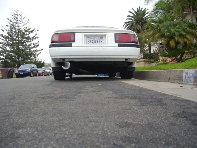

yeah aaron is the man! other than hitting boost cut the motor runs great, should just be a simple fix. i will be changing the filter out for my hks megaflow i just need a coupler. Here are some quick pictures, i was running late for work. ill throw some more detailed ones up soon!
