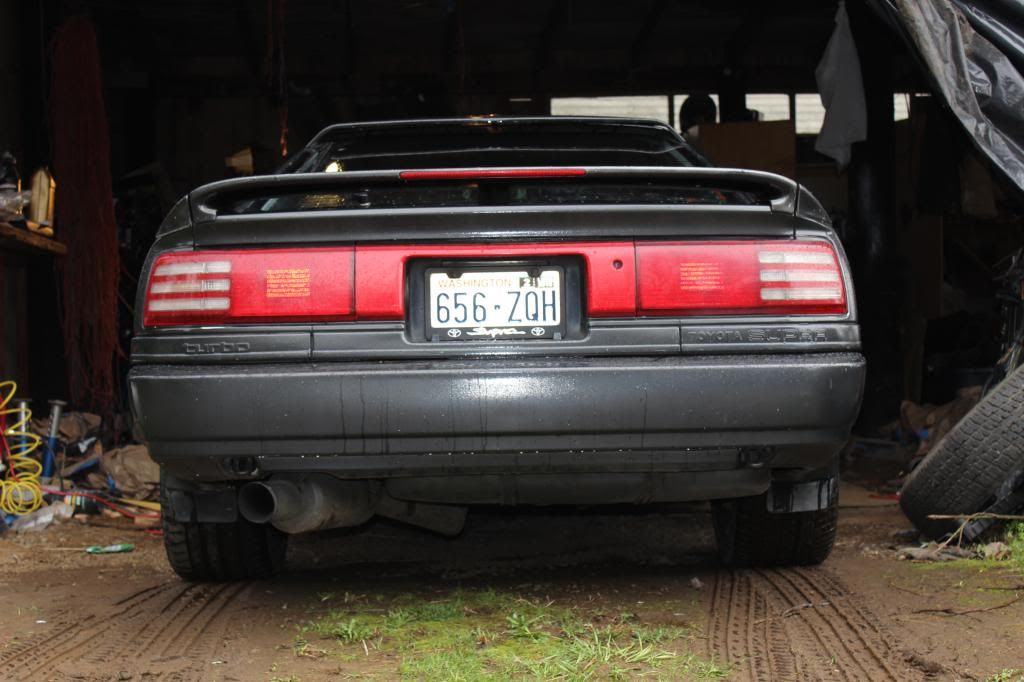

Yeah when I ran this exhaust I tucked it up as much as possible leaving very little space between it and the bottom of the car as not to scrape on the ground but after putting on these tires I feel like I'm flying it sits so high lol

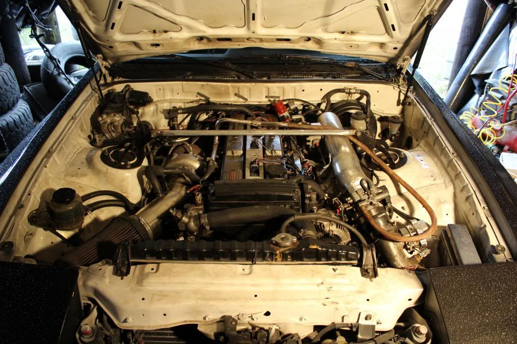

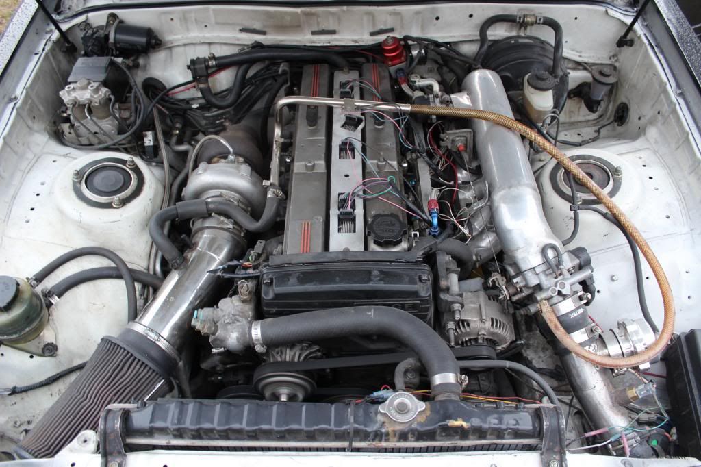

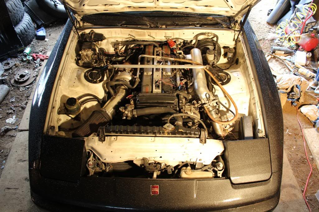

jdmfreak;1990540 said:
engine bay will stay white till i swap my built engine in (once its built)
im running the exhaust that i made after i put this turbo on with the muffler i was running when you saw it last
HOLY SHIT YOUR CAR LOOKS AMAZING!!!! I couldn't even believe that was your car... I had to do a double take. Okay... thats your house, that's your van... that's my parts car.... okay... wow.
As for the white engine bay... you know I love that!! I am going to clean up and paint my engine bay white when I pull the motor some day... it is in the plans. I think you should keep it that way, it looks sooooo clean!!!

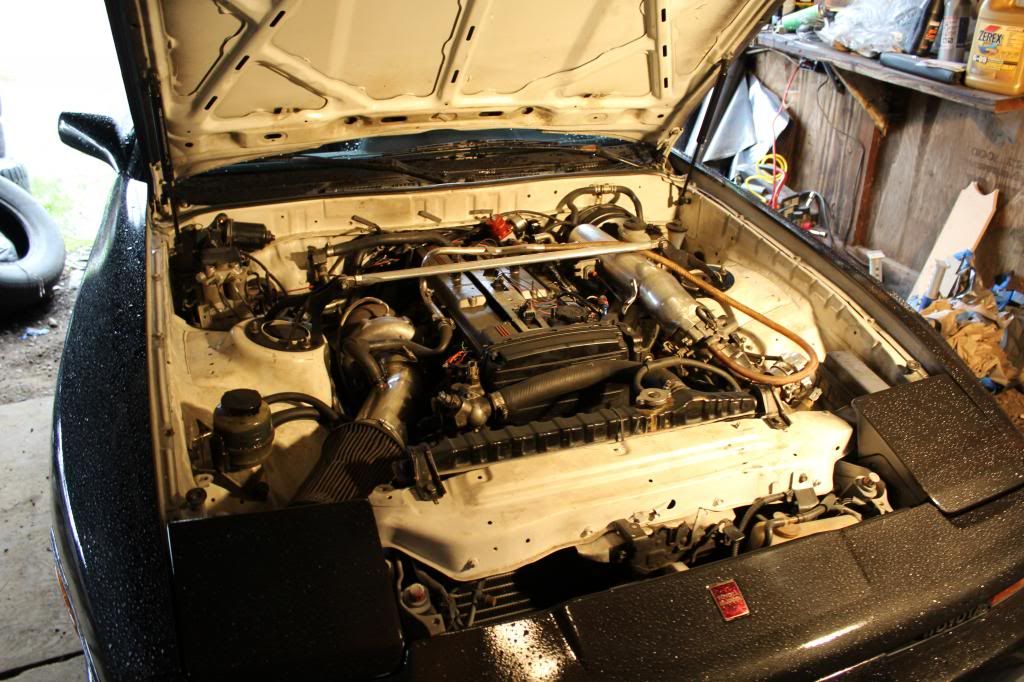

Had to replace bearings, caught it before catastrophic failure :)
All good now
I'm waiting on funds to build my turbo block
And waiting on a nice day to do a bunch of tuning, get my boost control dialed in a little better and whatnot
