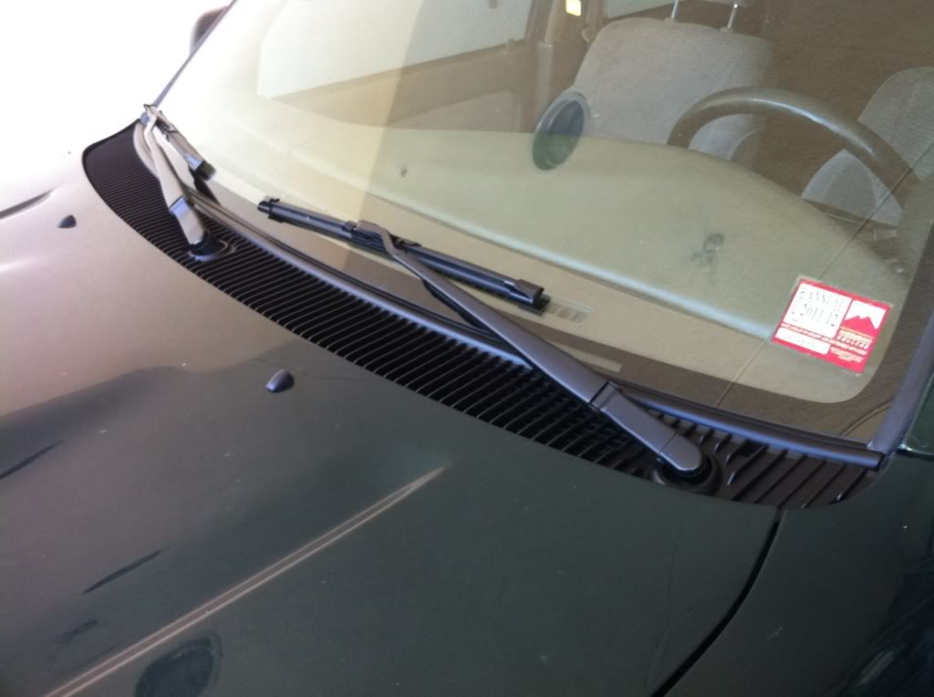

Trim black on my 99 4Runner's cowl, did this back in 2011.

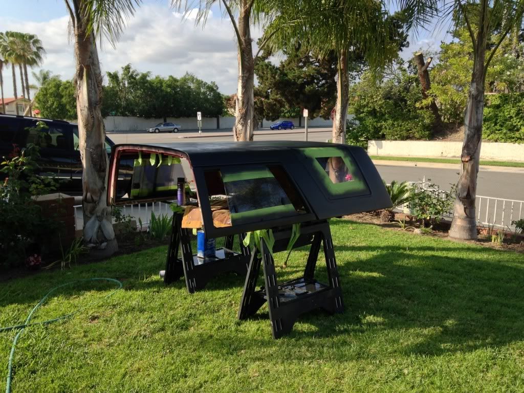

Black hardtop... been meaning to do the door frames and B pillar trim, those are the last remaining unpainted black parts
