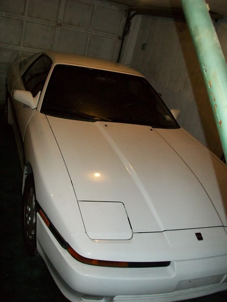

On my way to Pickup this! MINT Even has an under-tray!

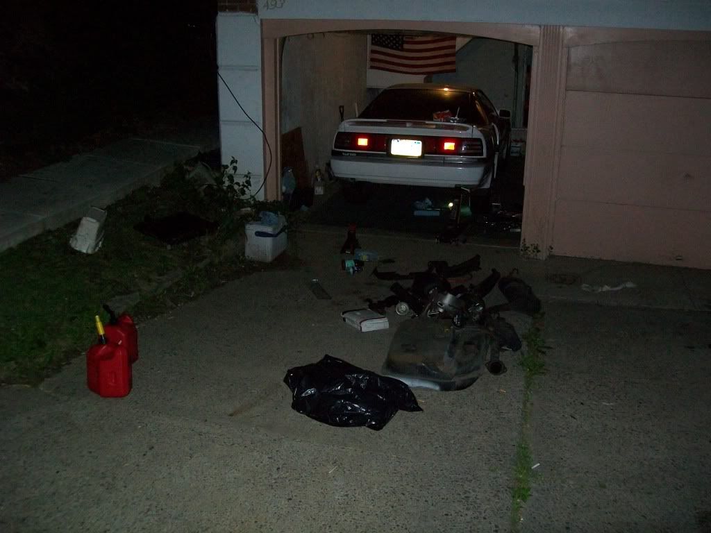

Update: 6/8/09
Car towed with AAA from NJ to Philly.
Engine is about ready to come out.
Fuel tank dropped.
My black POS is now at the garage ready to be prepped.
My car BARELY made it. 4th and 5th gear are definitely about to fail like the rest of the gears.
