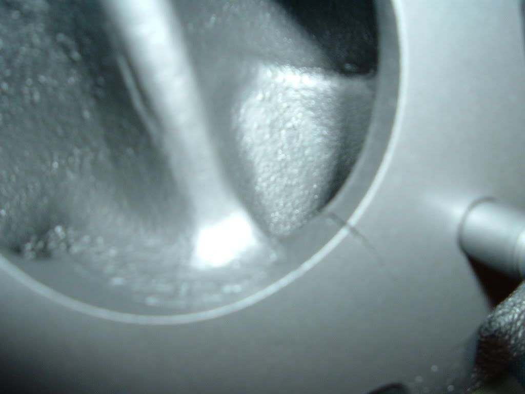

is this small crack a cause for concern

on the turbo exhaust manifold there is a crack thats small, only the first centimeter or two goes all the way through from where it starts it looks like, i didn't even know it was there until i got it back from ceramic coating it must have been caked with carbon build up the old gasket looked ok as in not rotted out
would have been better if the place that did my ceramic coating told me when they cleaned it up

Where's IJ when you need him...
I believe he could actually drill a small hole at the end of the crack to stop it from spreading if he really wants to do anything about it.
He could do that. That's what they do if there is a small body crack on an airplane. At least at the Airport I used to fly out of.
That would be my course of action ;)
I'd coat the gasket with Copper RTV and ignore it.

Seems like the vote is unanimous.
Never heard of that myself, learned something new today and it's only 7:30am... LOL!

Done it to stop cracks spreading in windscreens as well ;)
This is why you don't seam weld shells to strengthen them, you stitch weld them, if a crack develops it stops at the gap.
also known as blunting the crack tip.
