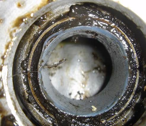

here's another picture i found from a past thread.
that damn blue thing, whatcha call it?
