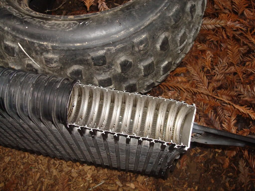

just to through it out there i cut open my old ic from my crashed car a while ago to see how they design the stocker. check it out. fins aren't that dense on the outside but look how dense they are inside of it.
