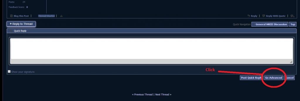

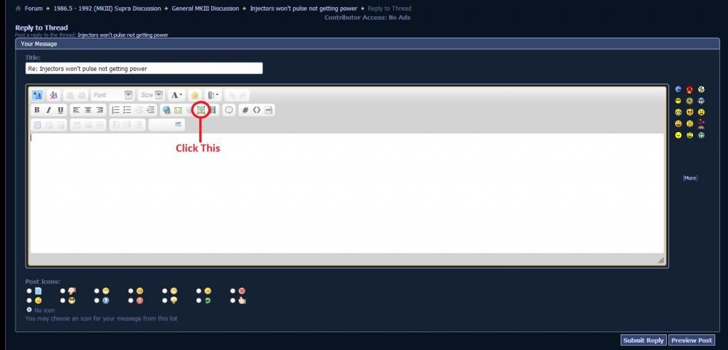

Depending on which theme you are using the colors might be different, but the buttons are the same.
First:
Next:
This will open a box that will allow you to select pictures from your computer.
