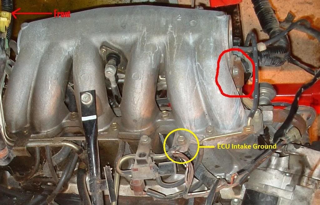

Next, if no codes is the case, please verify that the fuel injector resistor pack, is hooked up. You can see in on the right side of the picture located in this link.
http://www.ma70.com/bishop92t/techtips/7mlayout2.jpg
Also, the fuel pump will only operate during cranking and when the ECU is receiving the NE signal from the Cam Position Sensor. The fuel pump does not turn on with the key like some systems. Since you said that the engine does catch with starting fluid then the ECU is receiving an NE signal. But if you still wonder about the fuel pump you can force it on by going to the diagnostic connector and using the diagram shown in my first link by jumping +B and FP. This will force 12V to the fuel pump as long as the key is on.
