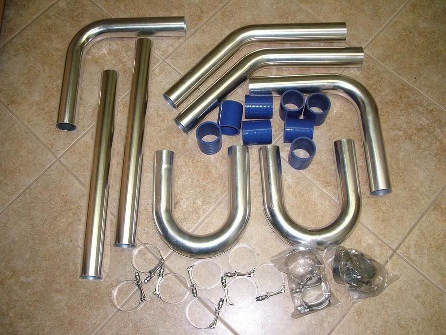

Here is the piping installed with the turbo xs bov pipe that he is also selling. I know the engine bay looks like ass, but the piping looks good...............:biglaugh:

The reason I said two kits from ebay is because I don't think one of thier kits would be enough for the entire car.
Jay: I was wondering where you got your kit from, now I know, lol. How hard was it making the universal fit in between the fender? Did you have the piping enlarged at the throttle body too?
One kit was enough. I already had the bottom done and didn't want to fool with changing it, but I would have had enough. The piping is 2.5" all the way to the throttlebody. You have to get a 2.75 to 2.5 reducer coupling (www.driftmotion.com) . It took me probably two hours to do all of the upper piping from throttle body to intercooler. I took my bumper off. I don't know how you could do it without taking the bumper off. It's real simple to remove though. As far as difficulty goes, I'd give it a 6/10. 10 being a pain in the ass and one being popping your hood...........................lol

compare what ebay kits offer vs what a drftmotion kit has, easy as that. We know the driftmotion kit will work, so if ebay has at least that many pipes (with the same amount of bends) then there shouldn't be a problem. Bad part is that ebay kits silicon hoses suck, not the mention the worm clamps.

the outlet/inlet of my ic that goes to the turbo is on the topside of the ic. thats another good 2 ft of piping that I'd have to have to make up for the stock setup.....i think. the parts the cheap ebay kits dont offer are the two u-shaped bends. for those of you who used the driftmotion or ebay kits, did you need or not need these bends. if you did use them, where were they?
I think I used it where it goes into the whole by the air filter. You cannot beat the t-bolt clamps that you get with the driftmotion kit though. I will never ever under any circumstances use anything other than these clamps and silicone couplings...................It's your decision, but the choice is easy.
