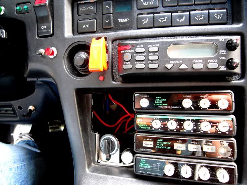

I remember when he did that, my favorite part was the "JET FIGHTER SWITCH" he installed.
The key is still in the picture though, for this to work, the key can't be in the plan.

Why push button start, thought I should chime in with why I did it & have been using the system for about 11 years on the Supra without any problems.
Far from being "stupid" it actually simplified a number of systems into one unit.
1) Insurance con-panies insist on them here so, you must install one. This is yet another box under the dash tapping into the ignition switch to stop it from working. So your switch is just sending power to.....another switch. Hmm.
2) Remote starting. Most alarm systems do this now & it's pretty handy, particularly when the miserable country you live in struggles to reach any double figure temperatures for a vast part of the year. Yet ANOTHER box tapping into your already double switch ignition & a whole bunch of additional wires. If a turbo timer was not built into my alarm there would also be ANOTHER module to switch the ignition for that too!!
3) I don't need my key for the doors which unlock remotely so, what if I could do away with the thing all together & combine the entire remote start, immobiliser & ignition key into ONE simple module with half the wires, ONE set of switches to go wrong & cut down on all the stuff on my key ring.
4) Security - there are NO power cables to be found where the ignition switch was so, nothing to tamper with or "hot wire"
The system I designed for the current rebuild is incredibly simple, tiny & incorporates all the above into ONE unit, ONE set of switching contacts (for each circuit ACC/Power/Start) & interfaces/deals with the all systems (starting, immobilising & remote starting) in One module.
It's also effectively gives the car ECU control over cranking duration which makes the car start really well every time, one touch of the button - no holding it in while engine cranks - just like a modern system. Acc comes on automatically when transponders read & ignition can be turned on separately as well as automatically powering up if you just hit start.
Seeming as I had to make up something to allow use of my cruise control with an after market steering wheel, it seemed obvious to also plonk the car starting/power on there too.
It's a clean, easy to use, obvious system. I didn't have to drill any holes in the dashboard for switches.
Boils down to individual requirements at the end of the day. I despise anything Apple make & would have every Ipod burned for the preservation of good quality music however, millions love them.
As for this post, there is a page on my site answering the original question about which wire to cut. HERE You cut the black/white wire to disable the starter position on the stock switch - although removing the pin from the connector is preferable & insulating it as then, things can be returned to stock if you want to.
Nope, no key at all, I don't even carry one. Just a transponder & alarm commander. Locking is all remote & trunks electronically triggered via remote or button.
The transponder just gets put into a dock where ignition key was, it's read by the ECU which then turns on the ACC position & livens up the steering wheel controls. If remote start is triggered, putting the transponder in automatically switches to run & you can drive away.
The steering wheel only lights in the options possible so, when the cars running only the off button will light. If you hit power the off & start options light, hitting just start automatically turns on the ignition & then cranks the engine.
The car is safety interlocked so, remote or button start won't function if the cars in gear.
To stop the car you either hit off or just pull the transponder out & all shuts down automatically.
I have automatic wipers, rear demist, tail & headlights running which are also linked into the system so they only operate when the actual cars running instead of just coming on with the ignition, this helps reduce starting current.
Interestingly I think the Syvecs (Solaris) stand alone has some push button starting option in built so, some of this may even be simplified again.
On the Rfid systems, I saw some expensive systems mentioned above, if you hunt the net a bit there are some of the well speced, although unbranded, alarm systems which have this built into them now at really affordable prices which gives you the walk up & walk away central locking. I'm sure these could also be hacked to switch ignition.
The only thing that worries me with relying on just proximity based devices is if the things decided to shut down suddenly for whatever reason, turning off your ignition. This was one thing that worried me when I first designed the system I made so, I put a fail safe switch into the transponder dock which latches the system to disarmed/powered up. This means the transponder has to be physically removed to turn the system back to secure & means the transponder only needs to be interrogated once.
The actual ECU for the system talks directly to the alarm ECU & sends out low current signals to the power relay switching side of the alarm system. This means there is only one bank of high current relays in the ignition system controlled by all systems. this keeps it really simple from a reliability point of view & the dual power lines of the Supra are kept standard, all fed from where they should be almost as if the stock ignition switch was still there.
The only thing that may bother some people is you loose the steering lock as that's physically moved by a cam on the end of the key cylinder - this has to be bolted off. This installation is all no damage so, everything can be restored if needs be or, if for instance, going into the spray shop, I can reinstate the stock ignition stuff in minutes.
