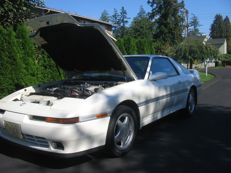

the ones off the 91-92 do you have a pic jsut to make sure?

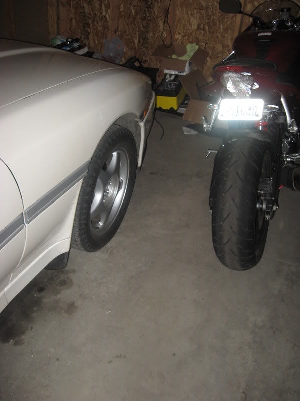

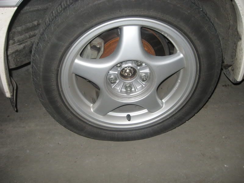

Dont mind the center caps not being there I took them off to try some new rims and havent put them back on.

oh yeah man those are the exact ones im talking about.. know anybody who is selling theres?

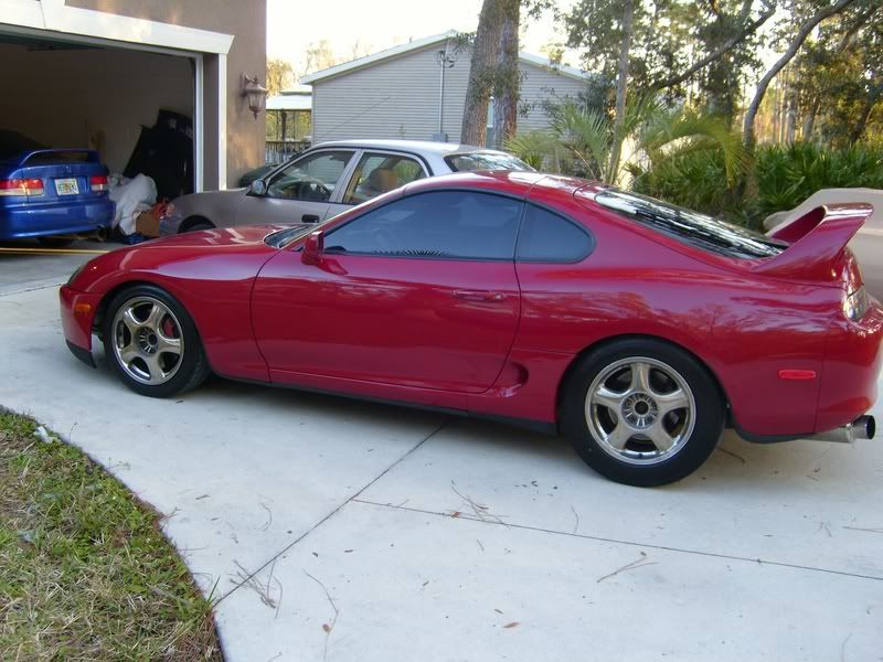

the mkIV ones are 16x9. sawblades are 16x7. i do believe. correct me if i'm wrong... i was just browsing catalogues at the rim shop to replace my cracked blade. duno about the offset. stock is 37.

ok here the answer to the OP.
5 spokes started in 90 on the white package only
91-92 got them on all cars.
they are 16x7, same as sawblades but alot nicer.
the mk4 has 2 variants. the NA models are 16 in and the TTs are 17. The mk4s are wider also.

the MKIII 5 spokes are actually about 7lbs lighter per wheel than sawblades too.
MKIV N/A are 16x8 (F), and 16x9 (R), MKIV TT are 17x8 (F) and 17x9.5(R).
You'll also notice the MKIV 5 spokes have a raised section in the center of the spoke, where as the MKIII spokes are flat.
