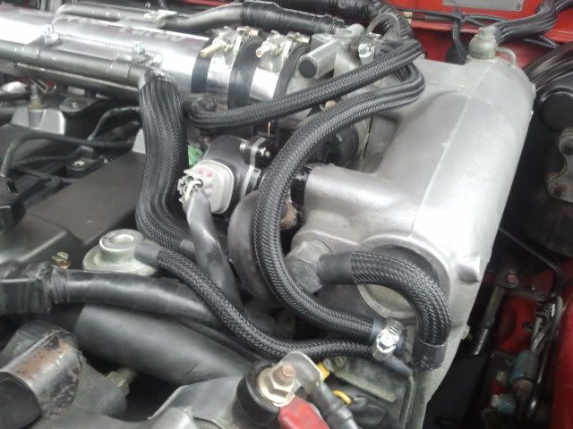

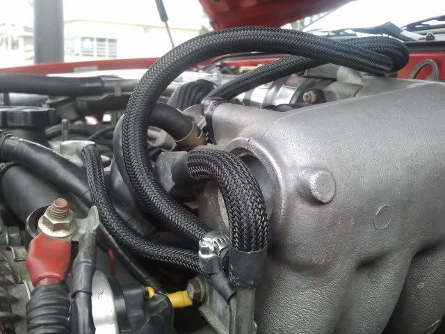

It goes to nothing on bottom of the intake. Its blocked off on the other spots.. I have a feeling this is not good what i did as far as the vacuum routing.....
I wish I could figure out my cold start issues haha I checked most of these areas also. I just do not have enough vacuum on cold starts for the car to idle right but once it reaches operating temps its fine :/
Since the CSI only operates during cranking, it cannot affect warmup (unless maybe it was leaking, in which it would affect normal temp running as well)
