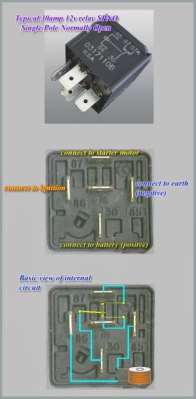

I'm sure you probably know about this relay mod, but I'll post it just in case you need it.
The UK supras don’t have a relay, the wire from the ignition goes straight to the starter solenoid (or via an alarm if fitted or neutral switch on a auto), one of the problems is the gauge of the wire, although probably ok when new is too thin and over the years the copper wire deteriorates, resistance increases due to age and the constant heat changes. The same thing would apply US supras with the wire from the relay to the starter motor ,When the resistance is high the volts will drop. A permanent fix is to fit a 30 or 40amp 12v relay in the engine compartment. The thin wire from the ignition activates the coil in the relay which doesn’t need a lot of current. The switching part of the relay takes care of the amps required for the starter solenoid, The large wire going to the starter motor from the battery is the main power to turn over the starter motor once the solenoid is activated, this wire doesn’t need to be upgraded.
Instructions;
1. Disconnect the battery
2. Fix the relay to the bulkhead or somewhere covenant.
3. Remove the thin wire going to the starter motor and connect it to terminal # 86 on the new relay
4.Connect terminal # 85 to earth (negative) using a 20 amp ( awg 12 ) wire
At this stage you can check the relay is working by connecting the battery
and switching on the ignition as you would normally do to start the car. You should hear a click from the new relay but the starter will not turn over until you have competed the next steps.
5. Remember to disconnect the battery again
6. Connect a 20 amp wire to the spade terminal on the starter motor. (This is where the thin wire was once connected.) Connect the other end to # 87 on the relay.
7. Connect 20 amp wire straight to the battery and to # 30. connector on the relay. Job Done.
