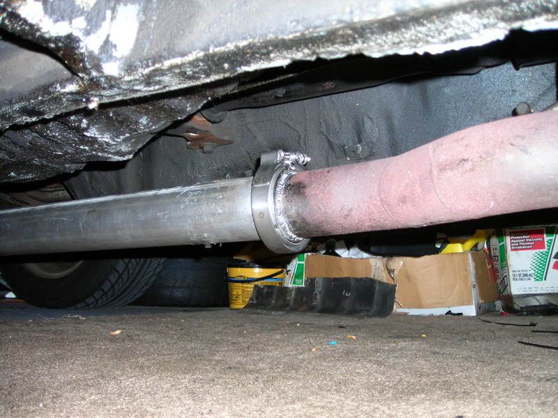

Well... it's been a few months, and here's my latest weld using my craftsman welder.
So I'm still learning, I haven't hooked up the gas yet... but I can't wait to try it.

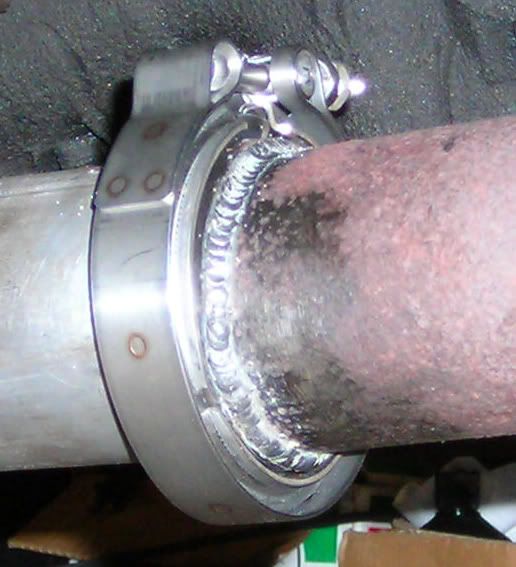

sweet job on that pipe. i got a $150 stick welder a while back for some basic welds. hard as hell to get the technique down but now its coming along great.
any tips/words of advice for me? i'm seriously thinking about getting a MIG setup in mid to late march.

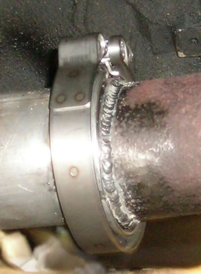

it's his technique....figure eights. I asked him myself a while ago how he achieved that kind of bead with a mig.
My MIG welds look like a stack of dimes too, just tighter grouping ;) I use a U shaped zig zag motion..

In your old pics, that's how my welds look - just a straight bead. How'd you get the stack of dimes look, in maybe a little more detail please for us other beginners?
When you do the zig-zag U, do you need to turn the heat up/down, wirespeed up/down?

I use a 2nd to highest heat setting with a lower wire speed... I can't really tell you the exact speed since I need to adjust it for thickness of metals... that picture I posted was welded to a "old" pipe that wasn't as thick as the new stuff....
It's a push technique, and more of a "looping" motion with the gun.
With the lower wire speed, it gives you time to do it and also allow for good penetration.

looking good man. what wire are you using? is it a stainless steel specific wire or are you using a mild steel wire? if you are not using a stainless specific wire, you should be. other wise, all stainless properties in and around the weld disappear. if you use a stainless wire you can still weld both stainless and mild steels.
