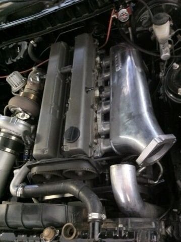

I had a similar FFIM and it hit my brake booster
The intake sits low almost below the cam gears about the same height where the headers bolt up. Do you think it will be closer to the bottom side of the brake booster? Ill have to do a test fit in the engine bay when I find some motor mounts.
By the way, where did you mount your Pro-Efi flex fuel sensor. Here is the pic from earlier post.

This is how mine was; and still didn't have the ports for the injectors. Which means I'd have to make special runners or it would be spaced out much further

Plus with the oem studs it made it impossible to install/remove. So bolts would ended up being used

The one thing I notice on your intake is at the back of the intake it overlaps some from the very last runner by the brake booster. Here is another pic of mine at the last runner at the rear with not much overlap. I do see how it looks too wide and cause a problem. Are you able to measure from your block side intake port to the brake booster?
