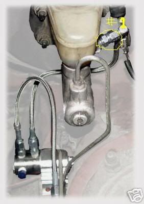

Borrowed this from suprarich...
This help?
socc924
396
CT and Philly
It confirms that we should install before the abs, unless we want to install 2 line lock kits. Am I correct with thinking that the line #1 is the feed to front wheels and the line lock just goes in between the source and the junction box it goes to.

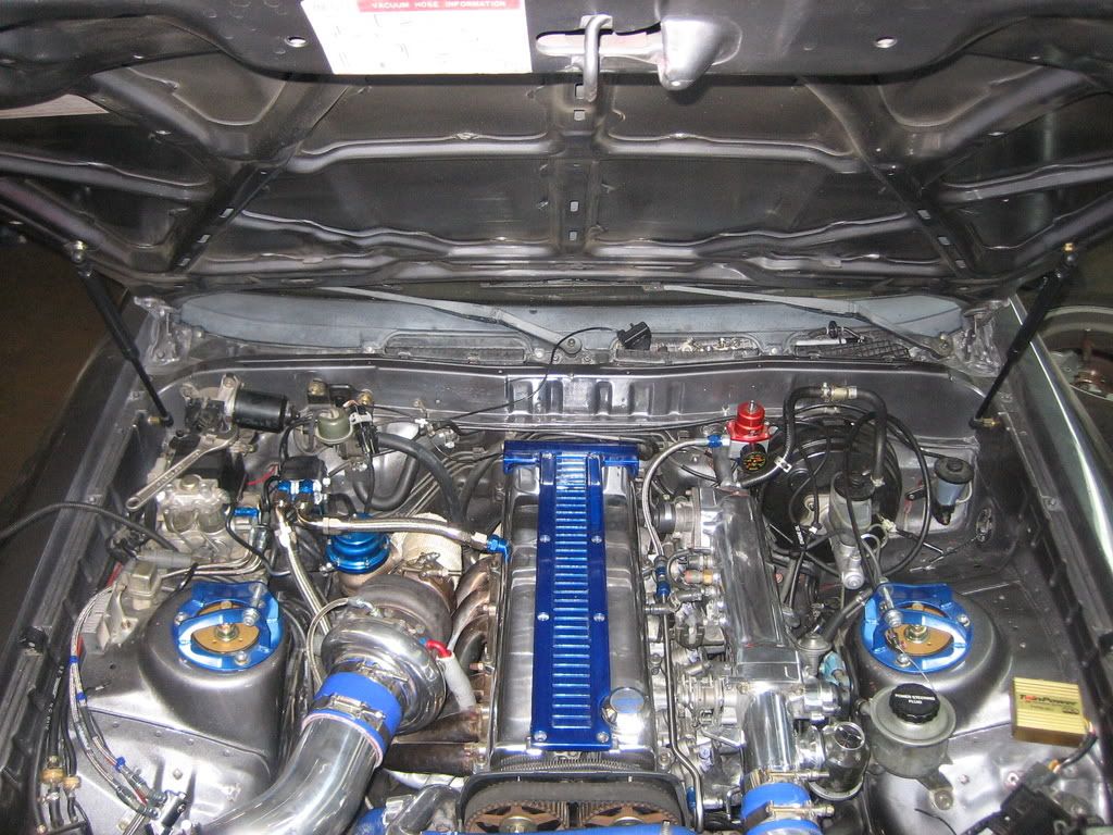

here's the best picture i have on my car, you will see a blue 90 degree fitting, that goes into the abs unit, that is where you want to tap the linelock into, when you look at the abs block you should see a F on the side where the brakeline goes into, for the front brakes, pull the factory line out, adapt taht line to the hurst linelock, then from linelock back to the abs unit, if you still don't get it, let me know when i get home i will take better pictures to show you i hope this helps and get you started!

Umm, that's a good picture of a master cylinder, but I have my linelock hooked into the other line coming out of the master. I have tried it and it works too, so I know I have it hooked to the correct line. I believe the front line goes to the front brakes and the rear to the rear. Correct me if I'm wrong, but mine works fine.
