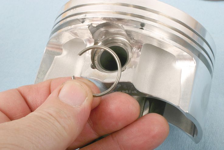

so im trying to figure out how to install thse wrist pin clips in my JE pistons. They dont have the holes like the stockers to to use that tool. What do i need to use to get these in??

Just did these on my Wisecos, my fingers were sore afterward. Not sure if there is any truth behind this or not, but I saw a few people recommending that the gap either be at 12 o clock or 6 o clock to reduce the chance of inertia popping them out. Seems far fetched but maybe IJ could shed some light on that. I put mine in with the gaps toward the 2 oclock position because I didn't read about this until after I had installed them.

I install mine so the open gap is just past the notch in the piston as this allows you to get a pick under the end of the wire so you can remove them ;)
Can't see the orientation making a difference to them staying put.

I think the idea was that if the gap is in the 3 oclock position inertia at high piston speeds (when the piston changes direction) could cause the clip to compress and potentially come out, but ya seems extremely unlikely.

LMAO maybe if was a rotary engine ;)
The Pins I use have a chamfered end and that helps force the clips into their groove unlike flat ends which sometimes hammer the clips out.

ok ill try with an alluminum piece to work it in.
My fingers are sore right now just from trying to muster one of them in with my thumbs! lol
i wish i could use that tool on these, it would be so much easier.

ok so i got the one clip in like you said IJ, but i just cant seem to get the other one in when the pin is in there. Its so tight, its almost like it wont fit. But i know it will. my fingers are so sore!! lol

ahh good idea. Ya i tried just pushing it with my thumb to move it just enough to get one end of the clip seated, but my thumb wasnt strong enough. I will certainly try that.

As for the clips, I cut grooves into 2 old valves and used my chin on a screwdriver to install them just like you would with your fingers (my fingers stopped working after 3 pistons) The end gaps were in the 6 o'clock position.
