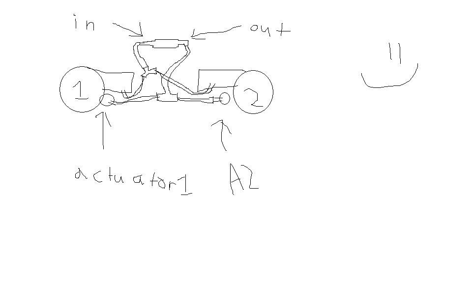

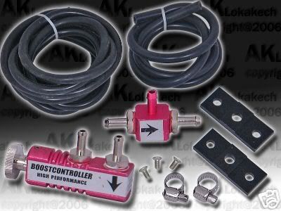

Now can you guy's help me with this boost controller?
I know how it pretty much hooks up but the twin turbo stumps me for the waste gate connection... Any one know how to hook this up???

Best diagram ever! You don't need to T the compressor ports together though, they are both measuring the same vacuum. I ran one of them into the boost controller and capped the other.
