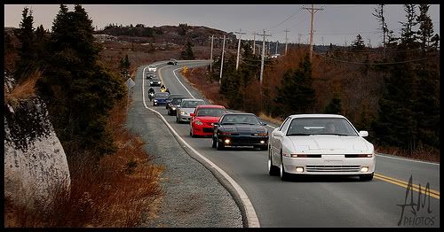

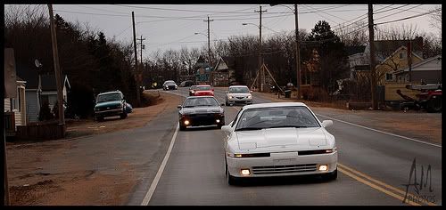

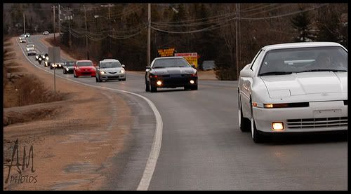

So here's the car as it stands right now, rolled the front fenders last night. Didn't flare them, only needed clearance for the very edge of the tread. Here's the cliffs notes of performance mods so far:
greddy:
-exhaust 4", TDO46H 20 g turbo kit, RC 550 injectors, turbo timer, Spec B boost controller
everything else:
-JE pistons, ceramic HG, AEM adj. cam gears, AEM fuel regulator, Oberg remote oil filter & cooler with AUX fan, 225 holley fuel pump, centerforce clutch, HKS bov, Lexus AFM & RCTS computer
