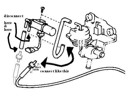

I attached the picture here and highlighted the fella in red. Thanks to whomever identifies the thing.

Goes to heater vsv
do this if you need to bypass it, otherwise connect it to hose off vsv
edit: and the other end connects to the empty side of this 'T' on the firewall
