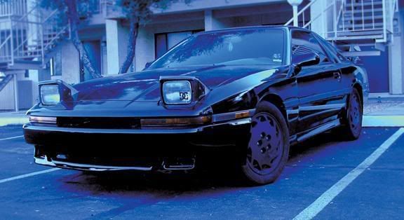

The fronts go lower than this, but the rears right here are basically as low as they go
87soup
F*CK SMOG CHECKS!!!
Jan 23, 2006
864
Sacramento
Thats Hawt!!!! I can dig that!!!
Thats on sawblades tho.... My KYB's looked super low on my sawblades as well!!!
Then my MKIV's turned it into a dump truck!!!
( i know i know... It's just the wheel and tire measurement... Just sayin)
